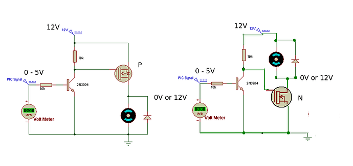

Difference between N-channel and P-Channel MOS-FET
the difference is where the load is connected
NO. Forget negative voltages for the moment. And forget about P-channel MOSFETs.
Don't let all this extraneous, unneeded information confuse you! Use the circuit shown in posts #5 and #18 (they are the same), with a logic level MOSFET.
