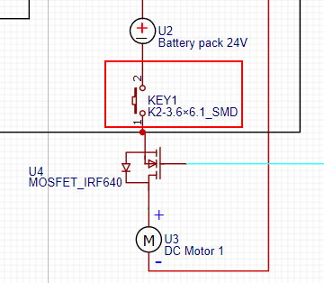

Helloo. So, I was trying to control this motor with an arduino nano and eventually the nano stopped working. I don't really know why and how to proceed. Here is a print of how my circuit looks like. The motor takes up to 5A current based on load. Somebody told me to use an optocoupler but I don't know if it can be fast enough for the pwm to work properly. I would love any advice :slight_smile:
*Corrected drawing
Your circuit shows an SMD-button.
Are you sure that this SMD-button can deal with a current of 5A?
To state the obvious: Did you press down the button when testing the circuitry?
The MOS-FET IRF640 has a threshold-voltage up to 4V.
What arduino nano is this 5V or 3.3V?
3.3V will be too less to drive the MOS-FET
5V might still bee too less for 5A
This depends on your PWM-frequency and the type of optocoupler
there are optocoupler that can switch really fast up to the MHz-range
best regards Stefan
I'm sure your drawing is flawed ("U5 VOUT to GND"??)
Please correct if needed, the drawing is a big help, thanks for posting it. The MOSFET chosen is a bad choice, I think you probably fried it because it did not turn fully on. It was a good choice as it is Repetitive avalanche rated and your design is good as do not need a flyback diode. The MSOFET diode will conduct at a lower voltage. Did it get hot? What was the heatsink capacity. Get a MOSFET that will turn on around 3.5-3V if your Nano is 5V. You will need a lower Vgs if it a 3.3V Nano. The lower the RDSon the cooler it will run. I would also suggest using resistor maybe 27 ohm in the gate lead.
Your circuit diagram has some serious problems: no gate resistor, and it is missing the essential flyback diode. It seems likely that the high voltages generated by the motor destroyed the Nano.
Here is the basic MOSFET motor control circuit. Be sure to use a logic level MOSFET (the IRF640 is NOT a logic level MOSFET).

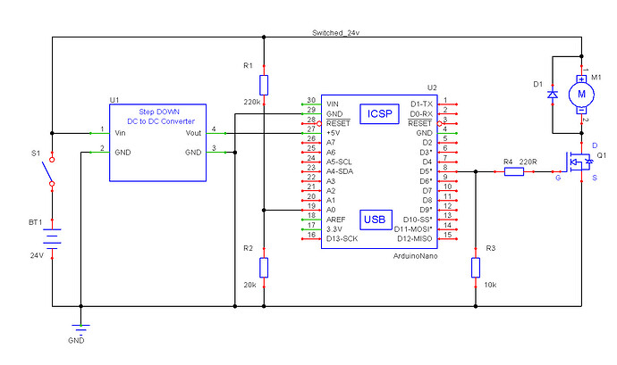

Omg I uploaded the old drawing, just a sec
this is the more correct drawing lol.
That is a on/off switch
Still wrong in many ways.
Thanks for the info. This is a 5V arduino. I corrected the drawing. That was a on/off switch not a button lol
Your schematic is drawn in an extreme non-standard way.
Place the switch in the positive line.
  • Positive at the top, negative on the bottom.
  • Signal flow should be left to right where possible.
  • Place a kickback diode across the motor.
  • Vin requires 7 to 9v.
  • Always use a logic level MOSFET when you use logic level gate control.
Thanks for the reply. The mosfet is still working and did not get too hot (not as hot as some other things I fried lol). I've read the datasheet of the mosfet I'm using and I think Vgs tells the threshold, it says 4V max.
I didn't even know these mosfet existed until now. Thanks for the info. But, doesn't it mean it needs to have a voltage the same as the Vsupply in the gate for it to open?
