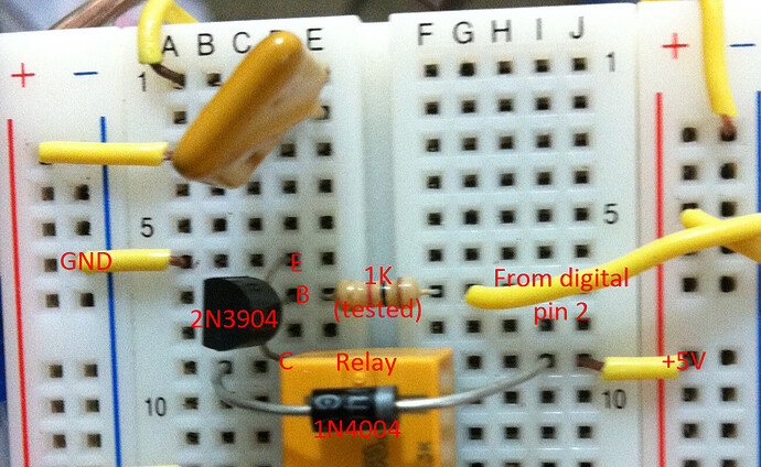

Im trying to switch on a 5v relay (Huigang HRS2H-S-DC5V) using a digital pin on my Uno, and for some reason when I set the control pin high, I only get about 2.4 volts across the relay, the rest is getting burnt across the collector-emitter of a 2n3904 transistor. I have everything wired up according to http://playground.arduino.cc/uploads/Learning/relays.pdf, the only difference is that I'm using a 3904 instead of a 2222 and Relay Power+ is connected to the arduino 5v supply pin. I have tried playing around with different base resistors to no avail. What could be going on?

That’s what’s got me so f%$@#&* confused, what am I doing wrong? I have tried replacing the transistor, connecting it both ways, replacing the relay, different resistor values, reversing the diode, replacing the diode, even changing the digital pin on the arduino, but yet I still end up losing half the voltage over the transistor. The only thing that works right now is the darlington, which I’d rather not use because it uses up 2 transistors. Here’s how it’s all wired with just the single transistor, maybe someone will see something that I’ve overlooked:
What's going on at A1 ? Can I suggest checking voltage across the left side + / - to ensure you have 5V there? You say you are losing 2.5V through the transistor, it's connecting to ground, so are you measuring from the E pin to ground? (after the 5V has passed through the relay coil)..? I wonder if the current to initially pull the relay in is too great? And 42mA is the current to hold it in?
tocpcs: What's going on at A1 ?
A1 is a 12 volt source going through a diode and a 750 mA polyfuse for some 12 volt electronics and a motor. Negative terminals are both connected to gnd, left side positive rail has +12.2V supplied by Vin, right positive rail has +4.85V supplied by arduino 5V out.
tocpcs: You say you are losing 2.5V through the transistor, it's connecting to ground, so are you measuring from the E pin to ground? (after the 5V has passed through the relay coil)..?
I am measuring from Collector to Emitter. I also measured across the relay coil and got about 2.3 - 2.4v

Attached drawing. Is yours set up accordingly?
560 ohm instead of 470, but otherwise identical
Have you measured the coil resistance (out of circuit) with an ohmmeter?
121 ohms. Just did some poking and prodding with the voltmeter and discovered that I'm only getting 0.7 volts out of my digital pin when its connected, and only 4.3 volts unconnected. 5 volt rail is still solid at 4.95V
