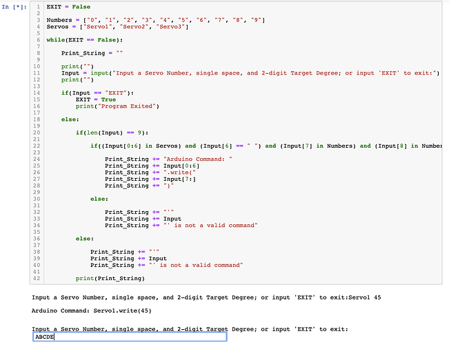

Here is what the analogous thing would look like in Jupyter Notebooks. In the white box at the bottom a user can type strings that correspond to moving a selected servo to a specified angle.
If the typed string is a valid pre-defined command, the result should either be that a line of Arduino code get uploaded to the board so that the arm carries out that movement. If the typed string is not a valid command, the result should be an error message displayed on the screen.

I shared the screenshot to give an idea of what the text input field would look like and how it would work. Except that for the real application I am going for, I would want the arm to execute the Arduino Command movement when valid strings are typed rather than simply display the code for the command on the screen. But if anyone has Jupyter Notebooks and wants to try the code, here it is:
