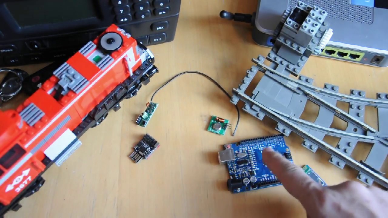

Controlling Lego Train with two arduinos over 433mhz
Hi guys,
I just completed a new tutorial, demonstrating how to control a Lego Power Functions train using an onboard Arduino, linked to a Master Arduino wirelessly. Here's the video:
All the code is available on the project website: arduinolegotrains.wordpress.com.
