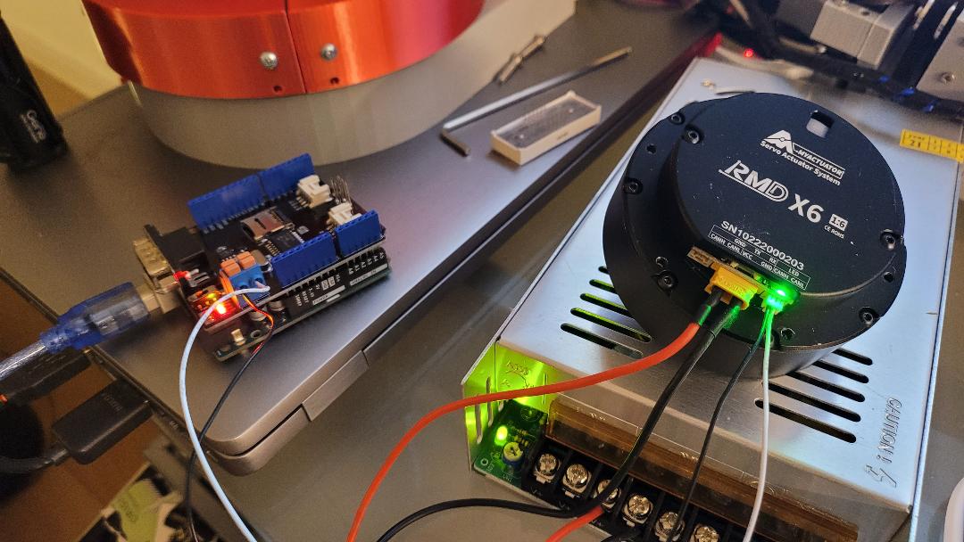

I would really appreciate any help as I've almost given up and thrown away hundreds of euros :frowning: I've tried everything to get the Adduino + CAN-BUS Shield + RMD-X6 to work.
I can control the motor using the USB UART and the MyActuator software.
What I've tried so far ..
  1. Added 2, 120 Ohm Resistors on each end of the cable.
  2. Tried removing one as I read there is a built in one on the motor side.
  3. I changed CAN_1000KBPS to CAN_500KBPS,
  4. I tried every ID (7,8,9,10,11,...).
  5. I got two shields, a Sparkfun Electronics CAN-BUS Shield and a Seeed Studio Shield.
  6. I tried using the newer mcp_can.h library and older one.
  7. I must have tried several examples.
I bought two of these motors, the RMD-X6 1:6 And the RMD-X6 S2 1:35.
I wrote several emails to MyActuator but no response.
The below code initiates fine but prints out "error" at the end of the code. I guess
CAN_MSGAVAIL is never equal to CAN.checkReceive().
I hoping obi wan kenobi isn't my only hope, can you help ?

Please post schematics. A block diagram showing an overview would be fine.
Poetry is never enough to make things clear.
Hi Railroader.
I hope this helps, I tried without any resistors, then one resistor at the shield end, then 2 at each end. The YouTuber Skyentific made it all look so easy.
lol, if I only had a brain.
Good block diagram.
Please bring up pen and paper, and show in schematics. Words like "resistor at the end" are not precise enough. No helper is standing behind Your back seing what You see.
Why not use the working UART concept? Why fight the unwilling CAN concept?

What version driver/CAN protocol are you using? In 3.5 0xA6 is not a command. I wrote driver support for OpenFFBoard for my X8-Pro actuators before discovering I had a old CAN protocol, and just got my rewrite finished.
Confirm that it is not using the V3 driver and the 3.5 protocol, as mine that I've had for a few months now shipped with

Well I have confirmed that the CAN-BUS communication is working, I got a second CAN-BUS shield and Arduino board and was able to send and receive with no issues, this to me confirms the RMD is not working, I tried very command with both the motors, nothing. I'm now reading about the ODrive, thank you. I'll continue to post here anything I can.
Hi there… i have same motors as yours ,the problem is that motor seems not working with single turn mode(A6), try to use A8 it should work i sent an email to the company about this issue
