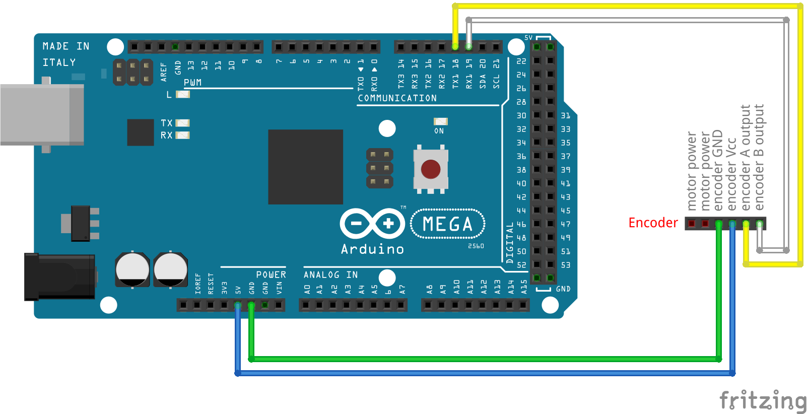

I am currently doing a project in which I am using a Twisted String Actuator for an assistive leg brace. My part of the project is coding the DC motors to run a set number of turns at a set speed and then reverse direction. I am extremely new to Arduino and have very little experience in any form of coding. From what I have learned so far and found online from other similar projects I have created a code (that will eventually control 2 DC motors but just 1 for just now) that should turn the motor at full speed (255) for 40 revolutions then pause for a few seconds before turning in the opposite direction at full speed for 40 turns. I was curious to see if tit was actually turning the set amount so I changed the code to run it at 50 speed (roughly 20% of max speed) for just 5 revolutions. When I run this code however, it appears to just be running at the speed I have set for the duration of the delay. I am sure this is what is happening as I have kept the number of turns constant but changed the speed and delay values and they seem to match with what is happening.
Can anyone help me with my code and see where I am going wrong?
The Encoder Counting section of the code I have taken from a project that was very similar and had a similar goal with how they wanted their dc motor to run and so I am not sure that it is correct for what I require.
Thanks in advance.
I am using an Arduino Due
a motor driver: Pololu - Dual VNH2SP30 Motor Driver Carrier MD03A
DC motor with encoder: Pololu - 4.4:1 Metal Gearmotor 25Dx60L mm HP 6V with 48 CPR Encoder (No End Cap)
the encoder is stated as having 211.2 counts per revolution of the gearbox shaft. It is a 48 cpr quadrature encoder.
Although the wiring pictures attached are for different arduino boards I think it should not matter
one_motor_with_encoder_take2.ino (2.71 KB)
attachInterrupt(2, rencoder, FALLING);        // 2 is pin 18
For the Due the interrupt number = pin number.
void rencoder()  {                                  // pulse and direction, direct port reading to save cycles    NB so this might be the bit that tells if the motor is going forwards or backwards
if (encodPinB1 & 0b00000001)   { count++;   }            //if (digitalRead(encodPinB1)==HIGH)   count ++;
else                   { count--;  }              // if (digitalRead(encodPinB1)==LOW)   count --;
if(run)
  if((abs(abs(count)-abs(countInit))) >= tickNumber)      motorBrake();
The commented code for the digital read is correct. encodPinB1 is a pin number, not its state. The interrupt is entered when the A pin falls, the state of the B pin gives direction for count++ or count --. With this encoder algorithm with interrupt on one pin/one edge you will see one quarter of the available counts. This is likely ok for the resolution you need.

I think my issue is that the motor is running at the speed I want for the correct number of turns
I do not believe that this is the case at all. Are you using a Due or a Mega?
Attached image shows a Mega, but the posting says you are using a Due.
I'm not certain you are ever entering the interrupt with your syntax
This would be pin 21 on a mega and pin 2 on a due, but the code indicates
#define encodPinA1      18                      // encoder A pin
RooDonald:
Hi Paul, I misunderstood your question earlier. I think my issue is that the motor is running at the speed I want for the correct number of turns I have set but I have no STOP function and so the motor is keeping its speed for the duration of the delay rather than being stopped. Can you help me with the coding for this? Do I simply 'moveMotor' again but set speed to 0 then proceed to the delay function?
I glanced at one of the data sheets for the control chip. I did not see any mention of "braking" capability. What have you found?
I am quite familiar with braking AC induction motors using DC. They STOP immediately! But DC motors I am familiar with have a brake on the motor shaft if they need to stop. The problem you are having is caused by inertia, or the energy stored in the moving parts. If you stop the motor suddenly, this energy has to be dissipated by converting it to torque in the motor mounts. That torque is then converted to heat in your mechanism.
Another way to slow and stop the motor is to use the back EMF generated by the motor and available if the power is immediately removed, by connecting the power wires to a small value resistor. For a small motor, the winding resistance is enough to allow the power wires to be just shorted together until the motor stops. IF you do this often enough, the motor will heat.

Firstly you must use INPUT_PULLUP mode on the Due, the trick with digitalWrite only works on ATmega
processors.
Secondly you are powering your encoder with 5V and sending its outputs direct to the Due pins which
are instantly destroyed by 5V... I would be more circumspect with this even if the outputs are open-collector
which is liekly - perhaps the encoder works at 3.3V anyway?
Thirdly if you want accurate position feedback you need a PID loop(*), you can't just hope the motor stops
instantly, because they don't. However if such accuracy isn't an issue the naive "brake now" approach may
be OK (depending on inertia in the system not being too high).
(*) Such a loop takes as input the difference in actual encoder count from desired encoder count,
and its output drives the motor bidirectionally. This means it can handle any overshoot and end up
in the right place.

Regards to your second point, I am using the 3.3V pin in the Due and you are right, the encoder works just fine with this.
