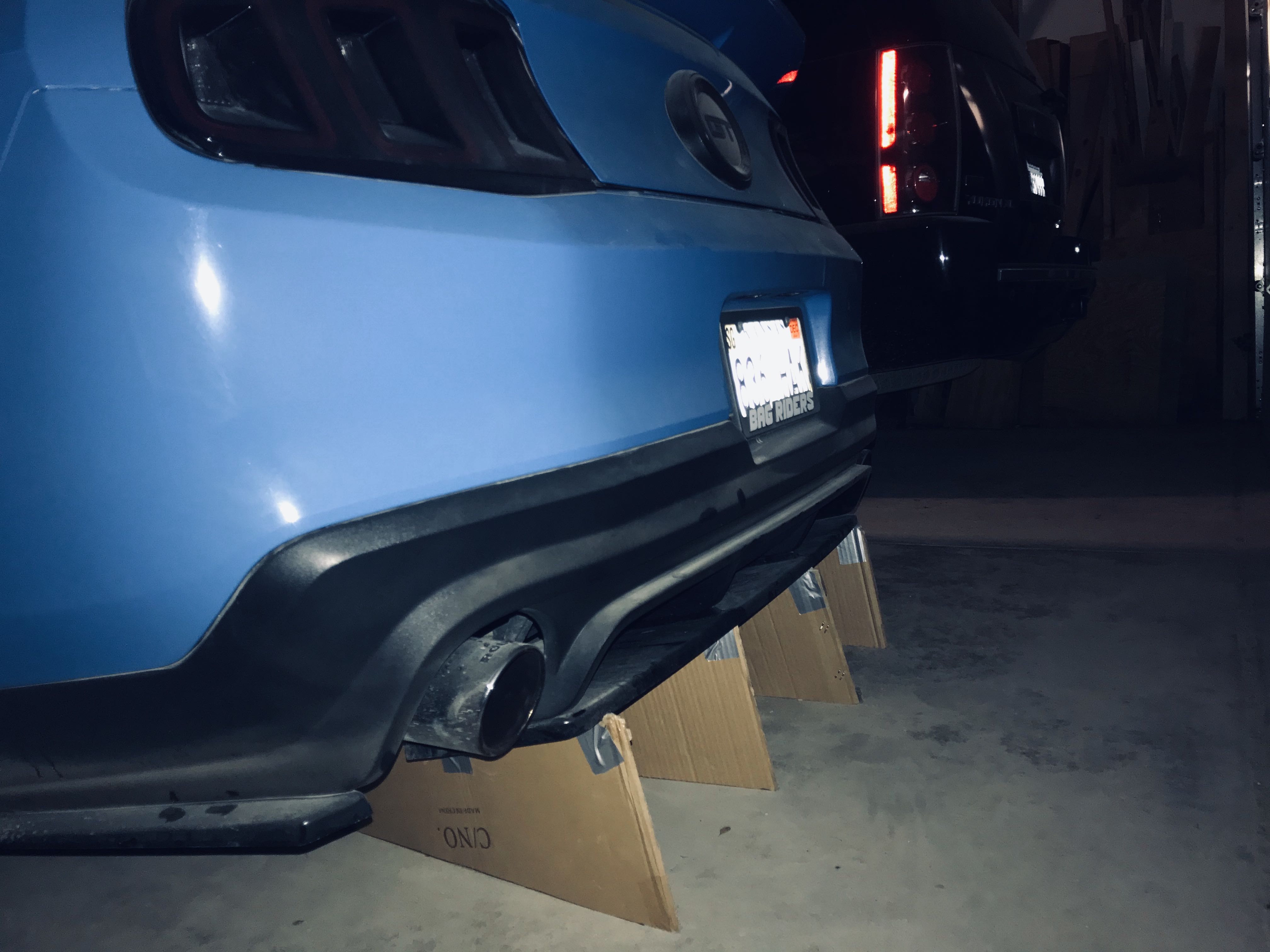

The project involves using an Arduino Uno to power two servo motors that rotate diffuser fins (Figure 1-temporary cardboard mockup) on a car with a single push button powered by the cars battery. When the user pushes the button, the servo motors rotate from their initial position to their final position and stop. When the user pushes the button again, the servo motors rotate back to their initial position and stop and the cycle continues at each press of the button. The two servo motors are to rotate in different directions and they don't have to be perfectly in sync with one another. Likewise, the two servo motors operate a mechanism to turn all six diffuser fins (3 turn clockwise, 3 turn counter clockwise) so they all fold nicely into the underside of the car. The mechanism is not necessary to describe as it all boils down to the two servo motors being able to rotate in different directions. Lastly, the holding power of the servo motors to hold the fins in position is not necessary as a locking device is used to hold the fins when they are in the up position.

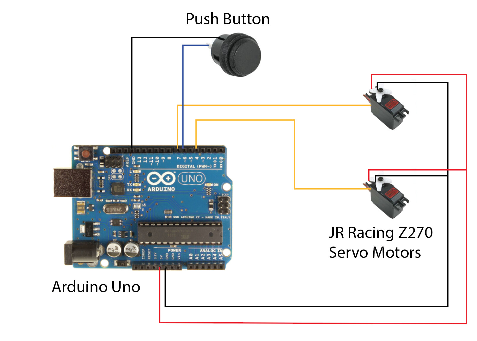

I have researched this topic on different Arduino forum threads for a while and found some code by the user "Zoomkat" to which I altered slightly for my project. (Code shown below). I don't claim to fully understand all the code listed, but a majority I do know. I have not bought any servos/buttons/converters/wires etc... as of yet because I wanted to gather some insight and opinions from experts. That being said, I did have some random parts laying around to which I was able to mock up a simple prototype. I connected two JR Racing Z270 Servo Motors to an Arduino Uno. Both servos are connected to the 5V pin and GND on the Arduino and their signals connected to pins (4) and (7) as demonstrated in the wiring diagram (Figure 2). A button is connected to the GND and pin (5) on the Arduino as well. Everything seems to work fine and operates as expected from my limited knowledge.

  1. What would be the best way to power the Arduino and servo motors from the cars battery? Power them both from the cars battery or use an additional power supply for the Arduino alone? Do I need a DC buck converter or other components to safely power the system without draining the cars battery or damaging the Arduino/servo motors?
  2. Is the code/wiring satisfactory? I mean does it provide a safe/reliable operation of the servo motors when powered by the cars battery? Will the servo motors draw too much current?

Servos will not operate on 12v battery (way too high) neither will they operate from the Arduino 5v output.(not enough current capability)
Arduino may get angry and at best, hot under the collar, at worst cook the guts out of the Arduino, running on a car battery when the voltage on the battery goes above 12V as is the case when it mostly goes to 13.8V while engine is running.
Those LD-25MG servos are best run at around 6-7V directly from a DC-DC converter and will need about 3A each. A high current converter may be hard to find so you could run separate 3A versions for each servo.
It would be best to run another small DC-DC converter to provide a separate 5V supply for the Arduino. Less chance of interference from the high-power servos.
But whatever you do don't try running those servos from the Arduino 5V pin.
Steve
Thanks for the replies slipstick and bluejets. I was not aware each servo would require around 3A for each one to operate sufficiently and that the Arduino 5V pin could not support enough current to supply them both, so I appreciate the information.
Going off of slipstick's suggestion, is it reasonable/advised to run three DC-DC converters from the same power source/fuse tap (2 for the servos and 1 for the Arduino)? If so, would a 10A-15A fuse be sufficient for the Add-a-Fuse?
Since I'm new to Arduino, I do not know if there is an easier way to power/wire this system on a car's battery, I just want to ensure nothing catches on fire or gets damaged. Thanks for your help, I really appreciate it.
