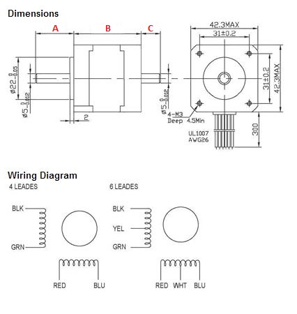

The stepper motor is EM-284 that is 12V 1A.

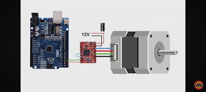

This is the wiring:

You have to adjust the motor-current with the tiny potentiometer on the A4988-driver-board.
Also worth connecting the Arduino GND to the driver GND
I connected the arduino GND to driver GND and arduino VIN to driver VCC too.
I know and I changed it but the result was same. At the first time the stepper worked but after 1 minute the driver became hot and Smoke rose from the driver. And then I didn't work at all. It is needed to say I connected the arduino to pc and connected the bower supply to driver at the same time.
is driver vcc the same as arduino vin ??!
Probably vcc should be 5v or 3.3v if it’s not too late
I would suggest set your power supply to something lower!
You need to measure the resistance of the motor coils. If they are too low, too much current will be drawn.

Did you connect the logic-voltage input to a higher voltage than 5V?
Did you adjust the current by measuring the reference voltage ?

Yes, Vcc of A4988 must be the same as the Vcc of the MCU - 5V in this case.
If the Arduino was powered with 12V via the jack, and Vin was connected to Vcc of A4988, then the driver will be burned.
While that is true, the design of these small stepper modules has a very poor thermal management, and the board can not really handle the full current limit the A4988 allows - depending on conditions. If you set the current limit too high the chip will likely overheat.
So I stand by my statement that the motor can draw more current than the stepper board can handle. And it is simply good practice to set the PSU to a current limit no higher than required. A short can develop for various reasons.
Sorry it's not VCC it's VDD and it's same as 5V or 3.3 V

if the motor has more than 4 connection and can be wired as either uni or bi-polar, is the driver configured correctly
The stepper motor has four unipolar wires.

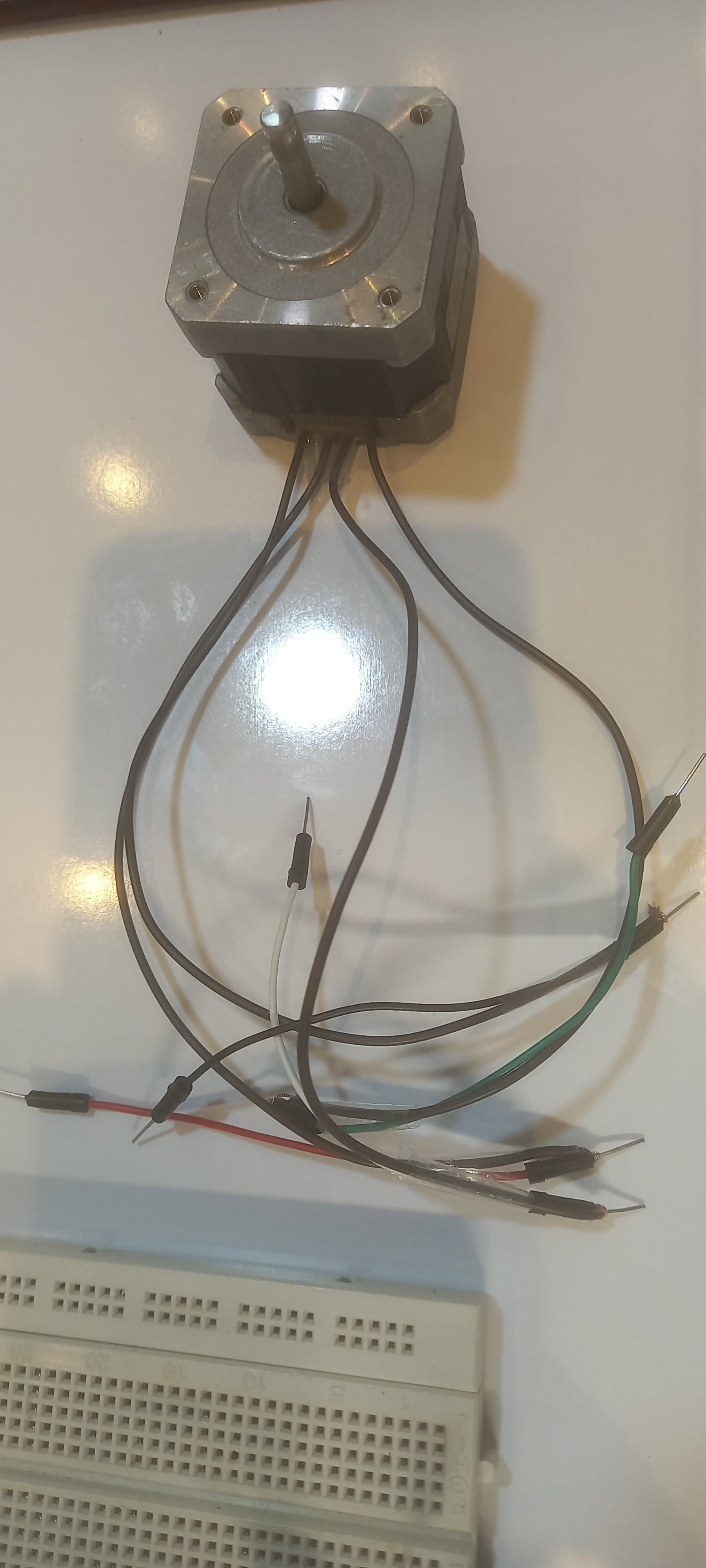

All the wires comming out of the motor look like they ar the same color.
So how did you know which wire is for which winding?
I suspect you had the motor wired wrong.

I think you had it wired wrong.
I tested the wires and I know from left the wires 1 and 3 are coiles and 2 and 4 are another coils. I tested the stepper motor with L293 sheild and worked correctly.
