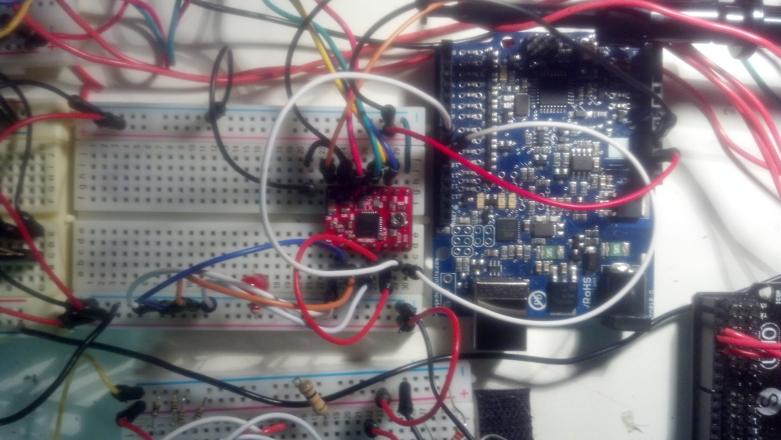

and nothing happens. I can see the STEP clock and DIR changing. I have 12V on VMOT, 5V on Vdd,
the MSX pins are grounded and RST & SLP are tied high.
No voltage changing on the motor pins.
The stepper motor was tested with a DK motor driver and the Adafruit Motor Shield example sketch "multistepper test"
I have no idea what's wrong. I tried turning off the motor power and reversing the motor winding polarity with no effect.
Appreciate any help to get it working.
NOTE: I should mention that my motor power supply is a variable power supply with current control and independent voltage and current displays so I can see if the voltage drops or the current goes up. The motor voltage never dropped and the motor current was 0.00 the whole time. I never saw any current whatsoever on the display. Also, the current control circuitry in the power supply has a relay that you can hear "click" whenever the current reaches the limit set by the knob. Never heard any click
and the red "Limit" led never came on. For all practical purposes, the driver is either not enabled or it is dead and if it is dead it couldn't be because it is blown because it never turned on (no current was ever measured).

I would try to eliminate the possibility that the power supply is the issue (relay needs to turn on as stated ). You have got to have another P.S. available sitting around.
Also do as you have stated to others about providing schematics and pictures of your setup (heed your own advice).
The power supply is a 24V variable , current controlled Lab supply. (one of two that I have) and I think you misunderstood my comment about the relay. I said that when the current reaches the limit set by the knob, the red Over limit Led lights and you can hear the relay click as it goes into Over-current limit mode. That sound can be used to detect overcurrent when you are not looking directly at the voltage display or the current display on the power supply. I just meant it gets your attention. Since I never saw any current on the display (and yes I tried the other ps and no difference) I concluded that the driver cannot be blown because it has
not drawn any current. Therefore , there must be another explanation.

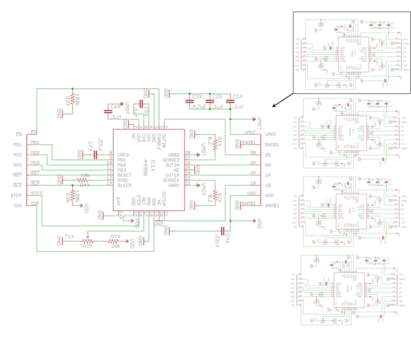

Attached is a photo of the circuit.
Also attached is a schematic that shows the pins on the breakout bd.

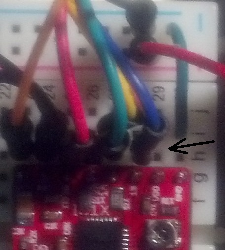

See the resistor in the lower left that says "trim"? That sets the current.
@polymorph, that does not adjust the idle current. It adjusts the max current through the motor coils.
@raschemmel - on my boards you can adjust the max current with a voltmeter - there is a test point. Look at the Pololu webpage for their A4988. That's where I got all the advice and it all seems to be correct and comprehensive. It seems (from another Thread here) that the max can be set to very low levels so that might be a reason for no action. If in doubt set the pot in the middle
Have you had a chance to check if reset and sleep are connected?

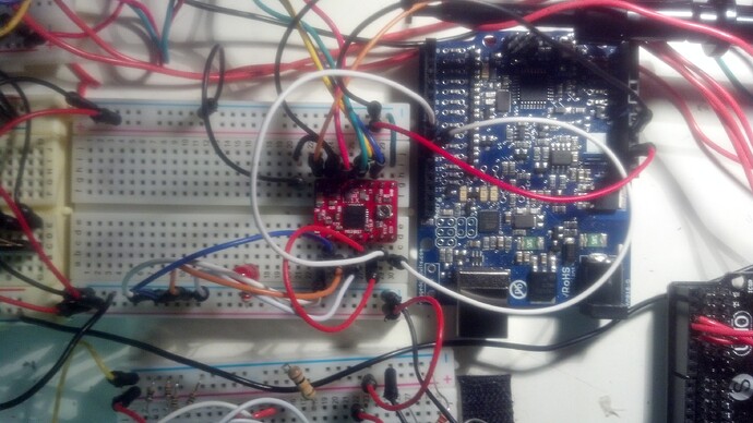

The Vdd is a small red 22 ga solid copper insulated (red) jumper hidden by the other jumpers. I have some 1970' s style solid pre-cut jumpers (the kind sold in a kit with about a dozen different sizes) . I'll replace every thing with those and repost the photo so it will be easier to see everything. I'll add a cap for VMOT but with no switching on the motor pins at this point it doesn't matter.
@raschemmel, I suggest you start over and follow the instructions on the Pololu A4988 web page if (as it seems) your driver board is the same as theirs.
My code (now that you have all of it :)) works for me using their wiring diagram and their boards
I followed the same wiring. As I said I am going to replace the flexible jumpers with stiff solid short jumpers tonight. I don't see how that will make a difference
It's beginning to look like there is a problem with your driver or it is different in some way from the Pololu version.
I would try connecting enable to GND and sleep and reset to +5 to see if that helps. (But you have probably already tried that).

Lookng back, I'm not clear if your power supply is variable voltage or variable current or both? If it is variable current, what have you it set to?
raschemmel:
Both. I set the current to about 150mA but with no current to measure that just means the knob is at the midpoint.
Have you checked the setting of the current limiting on the driver board? Might it be set too low?
I would be inclined to turn the power supply current up to 1 amp and the voltage to (say) 12v and leave the stepper board to do the regulating. My usual test situation draws motor power from a large 12v lead acid battery.
