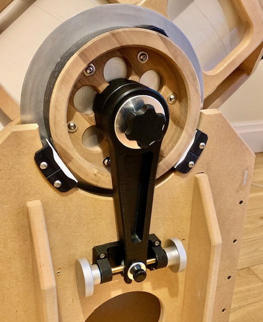

This is the manual version of the altitude fine adjustment, with torque arm and clutch handwheel for rapid movements:
And this is the modified version with the motor mount. I retained one hand wheel for manual fine adjustment if I ever need it:

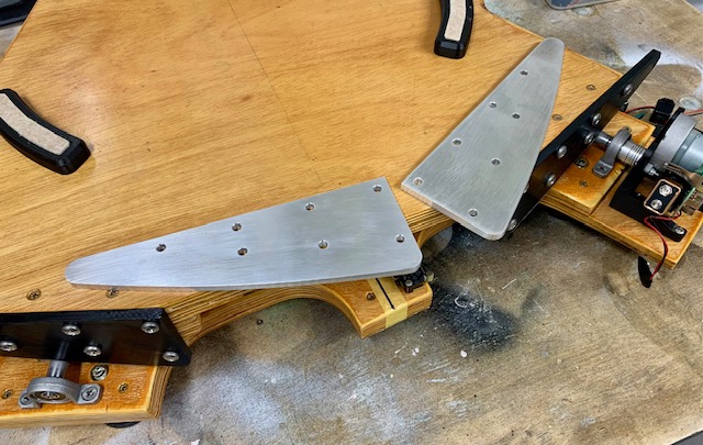

This is the equatorial drive, showing the 9V motor on the right, which friction-drives the black plastic sectors to rotate the platform. I've replaced the plastic sectors with the aluminium ones now.
