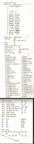

I am making an art project that requires me to control a thermal printer with an Arduino UNO. The printer I am using is a RONGTA RP820-US mini receipt printer. Please see below test page with printer information. BAUD rate 19200.
At first, I tried using a RS 232 to serial adapter to communicate. But I wasn't able to print anything. Please see below circuit diagram and code.

The TX LED on the adapter and the Arduino would be flashing (which indicates the transmission of data), but the thermal printer would not print. I tried switching the RX and TX wires, but nothing changed.
I looked up a diagram of the serial port (see below). I decided to plug my a wire directly from my Arduino TX pin into the TX pin of the printer (essentially bypassing the adapter).
205890c9f4e7d58fa8242ad716e6ba88c08533dd
This did get some result, as the printer began printing something -- however, this was gibberish text. I'm not sure if this is a viable solution and I just need to change some of my code, or whether persevering with the RS232 to serial adapter is the best bet.

Please confirm that you have printed the manual PDF and you have set the DIP switches, SW-7 and SW-8 to the Baud rate matching the Arduino.
Then your program MUST watch the RTS line to see if the printer can accept data from your Arduino. Hi = busy and LO = ready. This is also at RS-232 voltages. Does your adapter support another RS-232 line for conversion to TTL?

Hi everyone. Thank you for your help so far. To answer your questions:
I have tried switching the Tx and Rx pins in case I have them the wrong way. No change.
The Baud rate of the printer matches that of the Arduino (19200). I have tried changing it to 9600 using the switches, but still no action. Basically, Baud rate doesn't seem to be the issue.
Here is the link to the RS 232 to serial adapter: https://core-electronics.com.au/rs232-to-serial-converter.html?gad_source=1&gclid=CjwKCAjw17qvBhBrEiwA1rU9w8ciFtQk8rXsyqfvVgsBo9cnkBXgi8a02zc1NGLCoNFqJMjz2-e5pBoClGcQAvD_BwE
I don't think it has an RTS line so I can test if it's busy or not.
The printer and Arduino have power. The adapter has an usb input (maybe for power), but I haven't been using it as the lights come on when it is connected to GND and 5V of the Arduino.
On this adapter, the Tx and Rx lights flash depending on which way the cables are. But nothing seems to get through the printer.
Cheers
