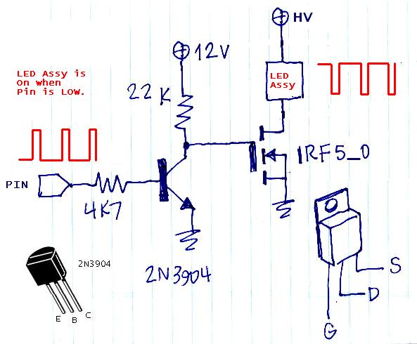

I would suggest an NPN "switch", assuming there are a couple of NPNs and some resistors in the house, as in the attachment.
Anyone could dispute the 22K, I suppose - go for a lower value - but it would be effective.

Elso:
P2N2222A
anything I can do with that?
I would just use the NPNs. The HEXFETs are overkill.
Adding schematic (attachment). Change RB to 1K-2.2K
It has "2N3904" there, but same difference.
