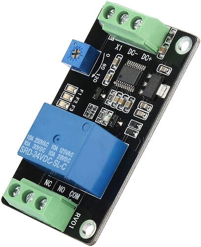

No code: This relay has a 555 timer and 0.1s to 2min timeout. Connect one to each ventilator.
https://www.amazon.com/gp/aw/d/B07XT84CNX/
This will put a strain on the ventilator motors, are they rated for this duty cycle. Also the mechanical section may limit duty cycling, you need to check into this or you could be purchasing some expensive parts.
