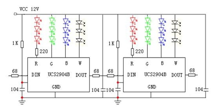

I'm attempting to control one of these UCS2904 floodlights using the Neopixel library; according to the chip documentation it uses 800khz and RGBW ordering, both of which are set in my arduino code which has been tested on both an Uno and a Mega. Regardless of board, the floodlight is powering on with its blue powerup behavior and then not appearing to respond to any instructions from either arduino. The same boards and code can operate 12V WS2811 strings without issue. I'm hoping someone has worked with these chips or lights before and can provide some insight!

You have the 4 channel controller... here is a link about the 12 channel controller.
The data sheet for this device is not very helpful, like most far East data sheets.
If you want to down load it Just click here
The thing with the 12V version is that each control chip will control 3 LEDs at once. So that they are not individually addressable.
Do not be cheeky, what makes you think that some one has to have worked with something before in order to "know" about things. All they need is the right information.
So looking at the page you posted for where you got them from it mentions that the interface was
Connectivity Protocol ‎SPI
This rules out any compatibility with the way that the Adafruit library works. Which does not use an SPI protocol.
Sadly, as I said, the data sheet does not describe the protocol to communicate at all. So unless you can find that you are stuck, for the time being.
