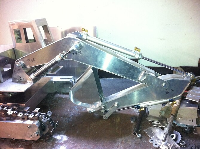

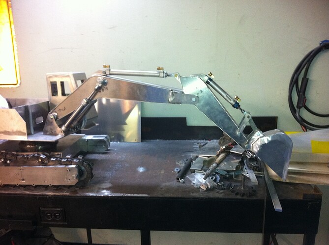

Can you post a photo of the excavator?

here is a couple pictures, its 4 feet long when stretched out, the tracks are 24 inches long.
Cool pictures.

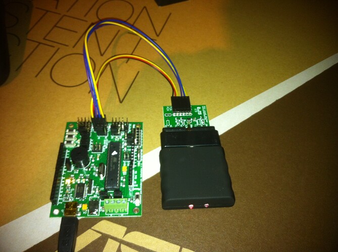

If I load the code supplied by HazardsMind it loads without error, but when I open the Serial monitor I get the flowing message
" No controller found, check wiring, see readme.txt to enable debug. visit www.billporter.info for troubleshooting tips
Unknown Controller type"
I don't know what is happening in either situation, If there is something I am missing or doing wrong ? is my playstation controller or receiver not working properly ? I did set the baud rate to 57600 to match what the programs both call for.
If anyone has a suggestion of what to do I would gladly take it, as getting the controller to talk to the board and seeing the communication on the serial monitor is the first major step I think I will need to take toward understanding how to get these two key pieces of the project working together. Keep in mind I am not experienced in arduino, this is all very new to me.
Thanks again for your time

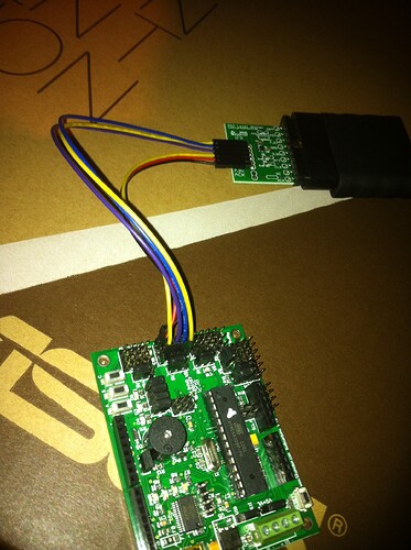

How is everything wired, can you provide pictures?
I have the wiring setup according to Lynxmotions website, since it is their controller and receiver, going to the botboarduino.
I will attach a photo, the receiver does light up on one LED, with the second LED flashing. When I turn the controller power on the second LED goes on. I am just using the power from the USB plug to run the board and controller.
What voltage are you supplying to it, 3.3 or 5? My wireless based only works at 3.3 so maybe yours does too.
greeting
I checked the voltage and there is a drop down built into the receiver board, it take the 5 V supplied from the arduino board and drops it to 3.3 in the receiver board. do you have a picture of how your board and receiver are wired together, after looking at the lynxmotion page I noticed in the literature they have this setup but ....
Pin 6 DAT , 5V PWR, GND
Pin 7 CMD
Pin 8 ATT
Pin 9 CLK
wiring diagram has different arrangement
Pin 6 DAT
Pin 7 CMD
Pin 8 ATT
Pin 9 CLK, 5V PWR, GND
Does moving the ground and PWR inputs really effect anything ?
I have tried wiring the board both ways that are provided on the webpage, always being careful to turn off the power ( usb cable )
and to have everything moved to new plugs before repowering the board. Both ways of wiring turn the same result, the receiver board has 1 LED on solid and 1 blinking, once I turn on the PS2 controller both LED's go solid. I have loaded each set of code I have one at a time and tried the serial monitor with no results. I am at a loss so far, after going thru the code on the PS2x program I did see that the printout in the serial monitor that says no controller detected etc. is caused by : else if(error == 1) . I don't know if this is any help, I hope it is.
Green wire is pin 13. Red = pin 10
Well I have gone over the wiring a dozen times to make sure it is all proper, and put new batteries in the PS2 control pad. still getting the same result of error = 0 , which then prints me off the " no controller check everything, call for help" response in the serial monitor. I just don't know enough about arduino to fix the problem. I have spent most my day going thru this forum and trying solutions that were suggested in other posts hoping to get this board and controller to talk.
any new ideas or suggestions would be appreciated.

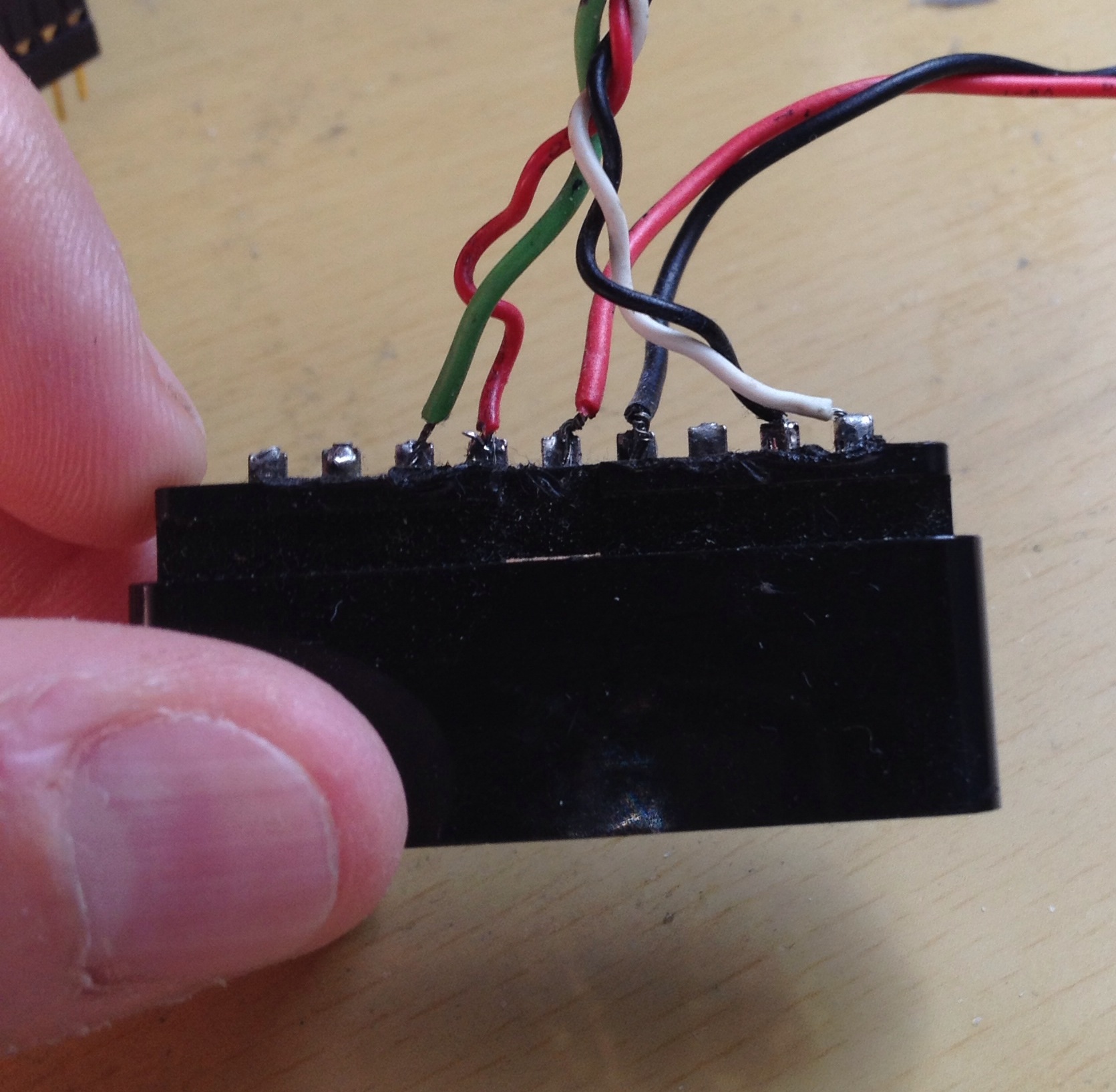

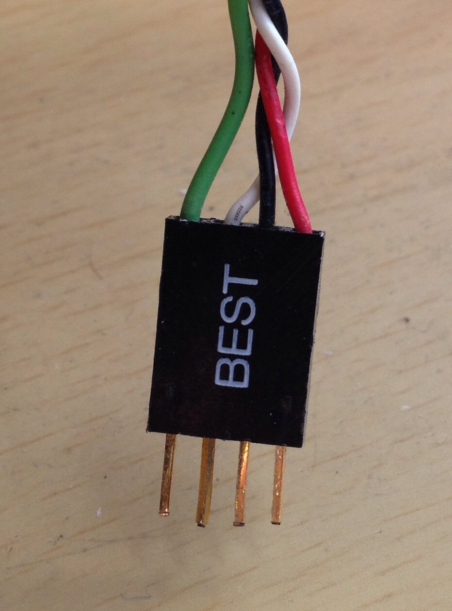

This might not help but it's worth a try.
I found out that my module does not like it when 5 volts is supplied, it too gives the same error. However I noticed that my module does not even need 3.3V to work. I could have the V+ wire off and it will still function correctly. If you can and dont break your current one, but if you can, make your own adapter the exact same way I made mine. Buy a PS2 extension cable and make your own. Or try different controllers. Mine is an INTEC and it took me a long while to figure out what my issue was, and it was only when I started to take apart the adapter (remove the V+ wire) did it finally work.
