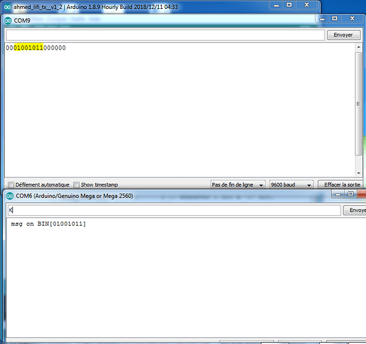

I’m receiving from a capture light sensor module, an binaire code.
i whould to convert them to code ascii CARACTAIRE
THIS’S THE CODE OF RECEVIER :
for (int i = 0; i < 8; i++) {
if (analogRead(ldr) >= 800)
{ arr = 1; }
_ else{ arr = 0; }_
_ Serial.print(arr*); Serial.print(’\r’);
i++;
delay(200);
*_

a few thing about your code:
delay(200)
is this the time for 1 bit?
not familiar LI-FI protocol but if all you are doing is using it as a media for tx/rx a serial (ie RS-232) byte then how are you determining the START or a byte ie
if no data is tx is “analogRead(ldr) >= 800” for example?
for serial tx for example, the line is HIGH when idle and LOW for 1 bit period to mark the start or a byte.
from there then all you need to do bit shift each read bit into a byte (char type) and print it!

What is sending the bits?
How does your sketch know when a new character is starting?
How does your sketch know when it is time to read a new bit?

0100001001000101001000000101001101010101010100100100010100100000 0101010001001111001000000100010001010010010010010100111001001011 0010000001011001010011110101010101010010001000000100111101010110 010000010100110001010100010010010100111001000101
Change to groups of 8:
01000010 01000101 00100000 01010011 01010101 01010010 01000101 00100000  01010100 01001111 00100000 01000100 01010010 01001001 01001110 01001011  00100000 01011001 01001111 01010101 01010010 00100000 01001111 01010110  01000001 01001100 01010100 01001001 01001110 01000101
Now they are ASCII.
If you want to interpret them manually: change groups of 4 into hexadecimal digits:
42 45 20 53 55 52 45 20 54 4F 20 44 52 49 4E 4B  20 59 4F 55 52 20 4F 56  41 4C 54 49 4E 45
And look them up in a table:
BE SURE TO DRINK YOUR OVALTINE
