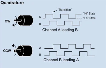

Couldn't you use the encoder library? it will do the right thing for you depending on the pins you choose.
To your questions
the current code looks at rising front
With PinChangeInterrupt, you'll get (as the name indicates) an interrupt every time there is a change, so both for the up and down front. Your ISR will need to deal with that.
PIND on an Arduino UNO is a register that holds the current digital input values of the PORTD pins. These correspond to digital pins 0 to 7 on the 328P
  • Bit 0 → digital pin 0
  • Bit 1 → digital pin 1
  • Bit 7 → digital pin 7
so
reading = PIND & 0xC;  // 0xC is 1100
will keep only the status of the pins 2 and 3 and
if(reading == B00001100)
will check if both pin 2 and 3 were high
the previous code uses and extra flag to see (aFlag, bFlag) to see where they are in the quadrature encoding.
