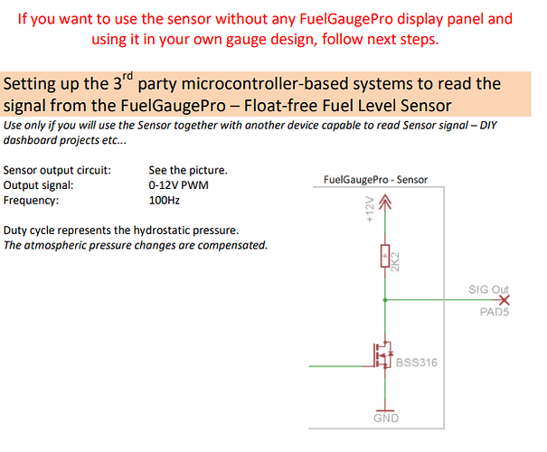

For the fuel level signal I'm using this pressure transducer which is designed to work with a standard fuel level gauge at a variety of resistance values.

The sender manual states it outputs a PWM signal.
I would first tackle interfacing this signal and reading the PWM value in the controller. Then you've got to convert that to a corresponding frequency for the tach input. DO NOT connect the output of the sample circuit directly to your Arduino! Do connect the GNDs of the two circuits together.

Am I correct in thinking that the arduino can only use a signal up to 5V, would this mean I'd need to apply a resistor to take the signal below this?

I'd use an optocoupler for safety. Also no need to connect the grounds that way. The signal is 100 Hz so no problem for a PC817 or similar opto, and it gives complete isolation.
