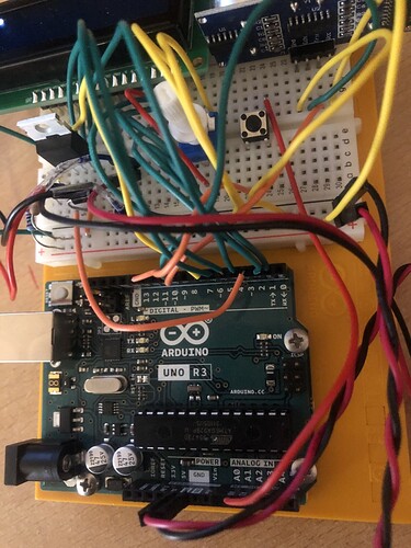

for this project I can keep it simple,
if button is pressed (motor stops after count reaches 6)and if button not pressed (stops after 3, )
system will start when... you plug it in bascily? it runs from the start
(sorry if im not being clear)
so when it starts you need to hold the button down for the 6 case
really?
yup
its just proof of concept i guess
now im thinking the button isnt wired up correctly? its not doing anything, I dont know why i wired it to a0?
(i think it was on a2 or a3 before i changed it to the better diagonal way, )
there is no a0, a2 or a3 mentioned anywhere in the code???
this is my code so far .....

I really appreciate everyone's help so far, sorry ye have to deal with a programming simpleton, I feel like it is getting there though!
pin 13 is the Arduino builtin LED
ok so pin 8, 11 & 12 are free? and the other wire from the button? leave it in a0?
you can use an analog pin just line a digital pin. configure is as INPUT_PULLUP, use digitalRead()
I see one wire coming from the button to A0. I don't see the diagonal leg connected to GND.
Is it my eyesight, or is that ground connection missing?

yeah ground is missing, i must have messed up when trying to change something (assuming i got it right at the start!)
one leg is going to a0, and the other leg to pin 13. so the one going to a0 should be ground, and the one on 13 should be.... pin 8?

One leg goes to what ever pin you define as buttonPin and read with digitalRead() to determine the state.
#define buttonPin 13 //A0? 8?
and the other leg diagonally across the button goes to ground.
