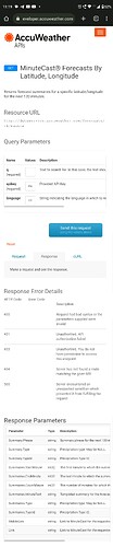

I have found some documentation regarding MinuteCast on their API website
Is it possible to get the values with the given URL and the commands? Using Arduino
I have tried it without Arduino in their website itself and it works perfectly
Here are some screenshots of it
Yes. That is what the library does with the other APIs.
With all these documentations is it possible to get/call the values from an existing library other than AccuWeather's library?
If so how we can do that?
Look at how the AccuWeather library does the other three APIs. Copy one of those and modify it to work with the MinuteCast API.
Hello,
Sorry for the delays I have tried modifying code where it calls the API and gets the values but it seems that that MinuteCast function seems to be not available in Accuweather's library it always tells me an error when I modify the part of the line where it calls the API...(Unfortunately, the code where I tried it got deleted)
I tried using the same code used for open weather API with a little bit of modification but it doesn't seem to be working there is also some confusion on the way the code calls the API because when comparing Accuweather core weather data and the MinuteCast there seems to be some difference in the way the data is being returned as there a huge difference in the way they told in the documentation and the way code is designed (As you can see from the previous posts)
or do you think is it beter to contact AccuWeather for proper library/support but i think that it will take a lot of time like months or they would just refuse to do it :man_shrugging:
Try this with your SSID, Password, and API key:
#include <ESP8266WiFi.h>
#include <ESP8266HTTPClient.h>
#include <WiFiClient.h>
#include <MyHomeWiFi.h>
#define apikey "tVhZeddCMqPW9GgbAfHIjlzExAam4T0X"
#define latlon "35.6762%2C139.6503"
  WiFi.begin(MyHomeWiFiSSID, MyHomeWiFiPASSWORD);
  while (WiFi.status() != WL_CONNECTED)
    Serial.print(".");
  Serial.println();
  const char * URL = "http://dataservice.accuweather.com/forecasts/v1/minute?q=" latlon "&apikey=" apikey;
  WiFiClient client;
  HTTPClient http;
  if (http.begin(client, URL))
    Serial.print("[HTTP] GET...\n");
    // start connection and send HTTP header
    int httpCode = http.GET();
    // httpCode will be negative on error
    if (httpCode > 0)
      // HTTP header has been send and Server response header has been handled
      Serial.printf("[HTTP] GET... code: %d\n", httpCode);
      // file found at server
      if (httpCode == HTTP_CODE_OK || httpCode == HTTP_CODE_MOVED_PERMANENTLY)
        String payload = http.getString();
        Serial.println(payload);
      Serial.printf("[HTTP] GET... failed, error: %s\n", http.errorToString(httpCode).c_str());
    http.end();
thank you so much @johnwasser the code work perfectly.
