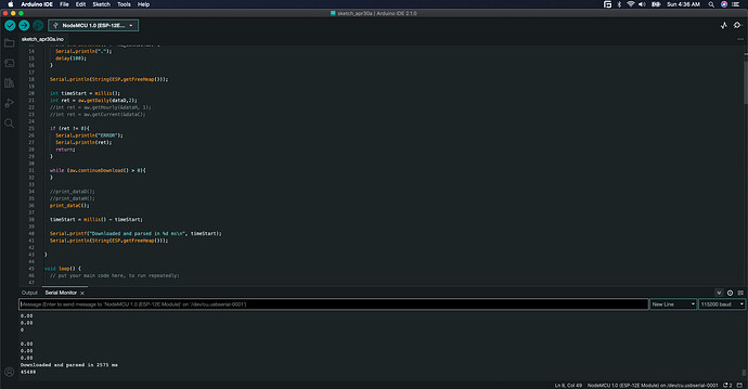

Here is the error I am getting :point_down: :point_down: :point_down:
/Users/vishanamarnath/Documents/Arduino/libraries/AccuWeatherLibrary-master/AccuWeatherLibrary.cpp: In member function 'int Accuweather::getCurrent(AccuweatherCurrentData*)':
/Users/vishanamarnath/Documents/Arduino/libraries/AccuWeatherLibrary-master/AccuWeatherLibrary.cpp:581:15: error: call to 'HTTPClient::begin' declared with attribute error: obsolete API, use ::begin(WiFiClient, url)
  581 |     http.begin(url);
/Users/vishanamarnath/Documents/Arduino/libraries/AccuWeatherLibrary-master/AccuWeatherLibrary.cpp: In member function 'int Accuweather::getHourly(AccuweatherHourlyData*, int)':
/Users/vishanamarnath/Documents/Arduino/libraries/AccuWeatherLibrary-master/AccuWeatherLibrary.cpp:612:15: error: call to 'HTTPClient::begin' declared with attribute error: obsolete API, use ::begin(WiFiClient, url)
  612 |     http.begin(url);
/Users/vishanamarnath/Documents/Arduino/libraries/AccuWeatherLibrary-master/AccuWeatherLibrary.cpp: In member function 'int Accuweather::getDaily(AccuweatherDailyData*, int)':
/Users/vishanamarnath/Documents/Arduino/libraries/AccuWeatherLibrary-master/AccuWeatherLibrary.cpp:644:15: error: call to 'HTTPClient::begin' declared with attribute error: obsolete API, use ::begin(WiFiClient, url)
  644 |     http.begin(url);
exit status 1
Compilation error: exit status 1
Links for the library : https://github.com/jackmax/AccuWeatherLibrary
Any help will be truly appreciated
Vishan
The library is out of date. If they don't provide a newer one you will have to fix their library.
Hi @johnwasser
This is the new library I got...
Can you give me any idea of how I can fix that?
I am new to this AccuWeather library and API calls
Could you please help me with this?
Thank you
Vishan
AccuWeatherLibrary.cpp line 581
AccuWeatherLibrary.cpp line 612
AccuWeatherLibrary.cpp line 644
http.begin(url); obsolete API, use:
http.begin(<your WiFiClient object>, url);

Thank you so much @johnwasser
It works perfectly
