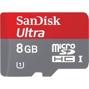

I recently bought a number of SanDisk cards from Amazon and some from Amazon sellers. Several were counterfeit.
Here is an example. I bought Sandisk Ultra 8GB, 16GB, and 32GB. The 8GB is clearly counterfeit Here is it’s CID and a performance test:
Manufacturer ID: 0X12
OEM ID: 4V
Product: MS
Version: 0.0
Manufacturing date: 5/2014
Type is FAT32
Card size: 7.99 GB
File size 5 MB
Buffer size 512 bytes
Starting write test, please wait.
write speed and latency
speed,max,min,avg
KB/Sec,usec,usec,usec
70.61,137276,2476,7242
70.77,136732,5280,7226
70.96,119376,5276,7206
71.02,119312,5216,7200
70.93,119272,5276,7210
71.03,119172,5216,7199
71.04,119156,5212,7198
71.04,119112,5216,7199
70.93,119152,5212,7209
71.03,119132,5212,7199
Starting read test, please wait.
read speed and latency
speed,max,min,avg
263.50,80812,1168,1937
264.59,2856,1168,1929
264.59,2856,1164,1929
264.60,2860,1168,1929
264.59,2860,1168,1929
The write speed, 71 KB/se,c and write latency,119 ms, are really poor. The CID is totally wrong.
