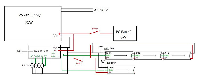

Complete beginner here. I've been reading through the forum and have looked for projects similar to the one I'm starting on. I found Multiple led stips from one Arduino to be most similar and so am working to understand that. I have a couple of questions which I'd be grateful for help with. The final diagram in that referenced post looks like this:

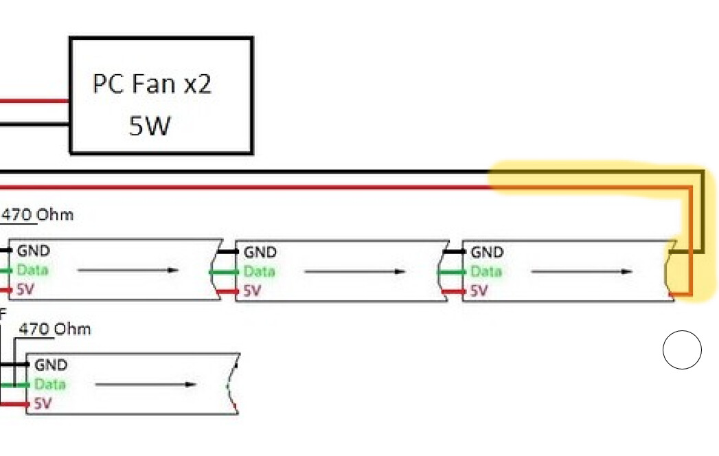

The diagram shows 3 serial LED strips and a single parallel one. I'm curious to understand why the power line on the 3 serial strips goes back, whereas it doesn't on the parallel one. Why is this required in one case and not the other?
To make it clearer; this - why is this required?
My second question regards the 1mF capacitor - I'm not exactly sure what I need to buy nor how to wire that in so I need a bit of advice on that please. I'm guessing I don't solder it directly to the LED strip but instead across the black/red wires ahead of the strip somewhere.
My own project will have 3 parallel sets of 2 strips in series. I'm making sure I get it wired up correctly before I start breaking things!
Thanks for any help

When using a series of addressable LED strips fed with power from one end it is possible that the voltage drop along the length of the combined strips could be such that the operation of the later LEDs is affected.
To alleviate this, power can be fed to both ends or intermediate positions along of the combined strips. This is probably why the diagram shows this
1000uF electrolytic. Solder the capacitor + to VCC and - to GND of the RGBLED strip. This is for power smoothing. Don't forget the 470R resistor on the data pin, also for surge suppression.
And for preventing reflections on the line, which can destroy the signal integrity.
