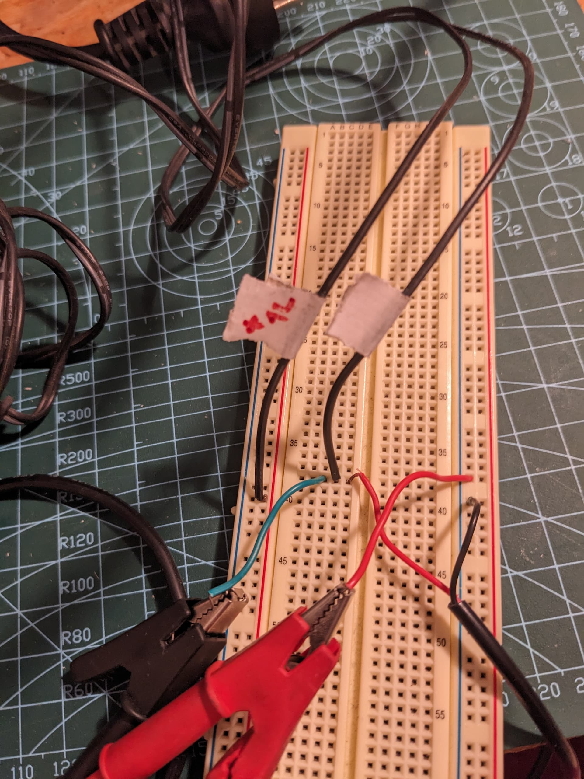

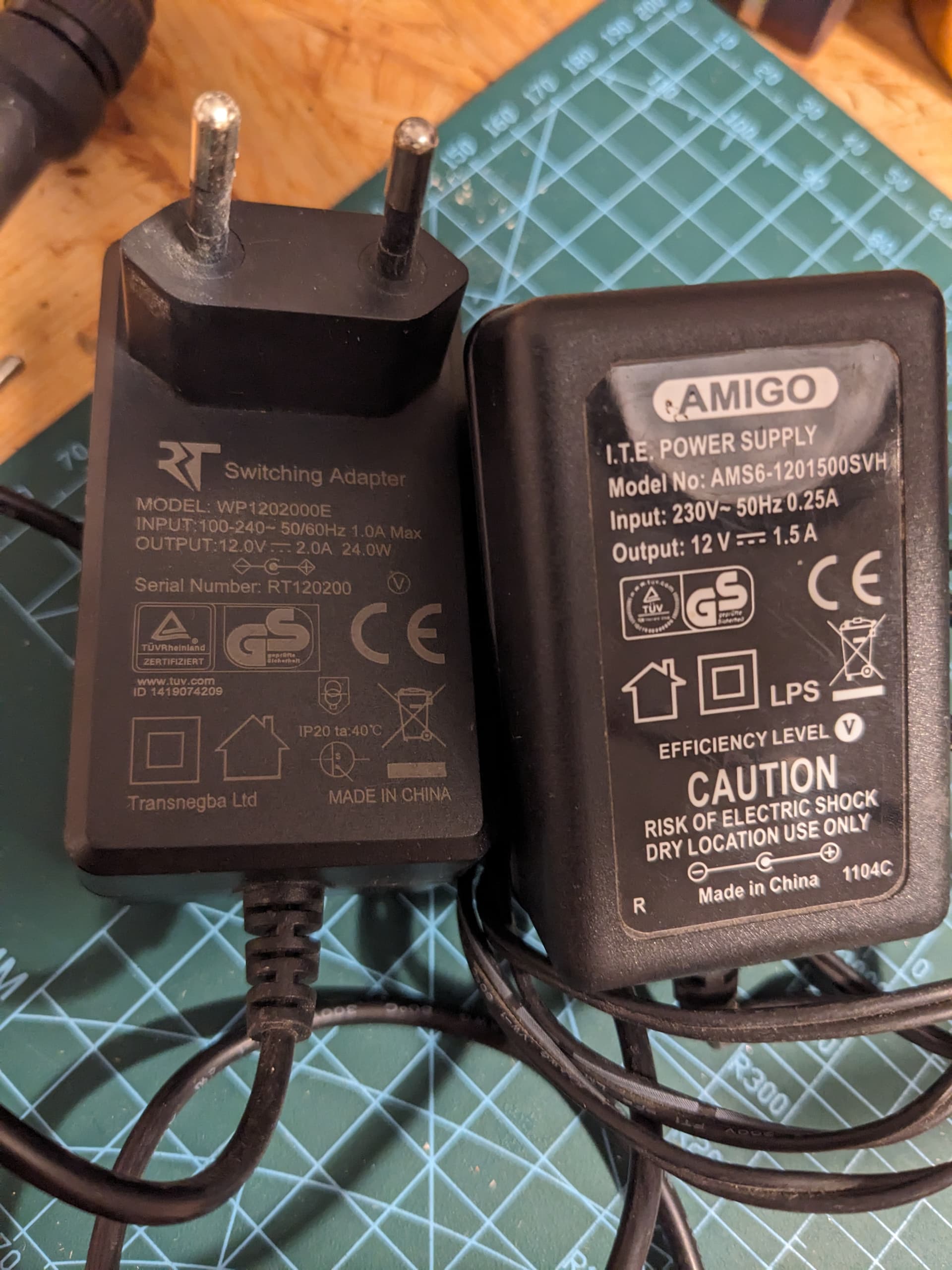

Then one is 13V and the other is 12V.
Are you saying that when not joined they are "12V" each ?
I note the specs are different.
I guess I should just find 12V PSU that is actually deliver 12V and not 13.7V
If that's important.
Maybe with a load the voltage will drop a bit.
Switchers can be like that (some minimum load required).

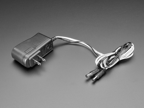

Adafruit sells a +/-12V adapter which may serve your specific need. Unless of course there are other requirements you haven't mentioned that would rule it out.
I was going thru my box of wall warts a few days ago. One rated at 12 VDC at 1 Amp shows 18 VDC with no load. My project was very lightly loaded, so I didn't use that one.
Add some 'wall warts', especially the oldies, have only a transformer, a bridge rectifier and an electrolytic capacitor (ripple smoothing).
