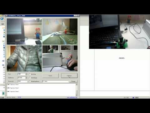

This is the overall concept I was going for (except with multiple mini cameras and the NEMA 17 motor):
This was a useful website for "4CAM VideoStreaming", but not the "still shots" that I was hoping for:

In the most simple way I can state it, I have a 200 step/rev motor and I want to be able to have the 4 cameras take a picture every 10 steps to obtain 80 pics ((200 steps / 10 steps) * 4 cameras = 80 pics). So every 18 degrees, I wanted to program the arduino to simultaneously take a picture using these cameras and save them to the SD card.
