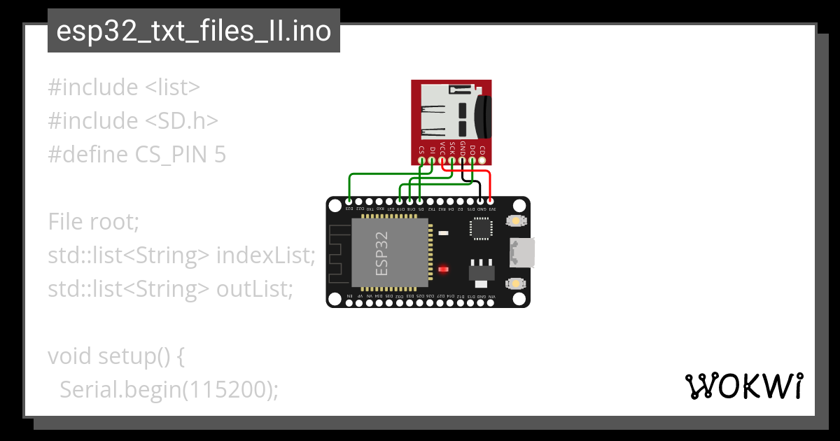

Hi @sergioarduino,
this is a code that seems to do what you intend:
#include <list>

I have not checked the sketch for efficiency or memory consumption ... There may be some flaws but it could be a begin for further steps.
You can try it on Wokwi:
I could not check the writing to SD card on Wokwi, but you may try it in a real application.
Good luck!

FileA.txt:
0,B123,USUARIO TESTE,E5
1,X001,SERGIO FRANCA,F1
2,H002,LUCCA DA MATA,F2
3,M789,EMILLY MONTEIRO,F3
4,S111,JOANA FRANCA,EM1
FileB.txt:
0,B123,USUARIO TESTE,E5,segunda-feira,31-07-2023,19:58:00
1,X001,SERGIO FRANCA,F1,segunda-feira,31-07-2023,19:58:00
2,H002,LUCCA DA MATA,F2,segunda-feira,31-07-2023,19:58:00
FileC.txt: (Should be)
But it just prints:
I guess the reason is this:
The code as it is at the moment expects a Line Feed after each relevant line ... You can try to put an empty line after the last entry. That should work...
If you don't like that restriction you may change the reading algorithm to react on Line Feed ( c == 10 ) and also if aLine is not empty after EOF has been reached.
You are amazing.
Cheers.
Hugs.
Thanks .. But it was a "flaw" in my quick solution... :wink:
Minimal thing. The important thing was their motivation to help.
How is this part ?
if (c == 10){
        String idx = stripIndex(aLine);
        if (idx != "") {
//        if (idx > "") {
           if (!indexFound(idx)) {
            Serial.println(idx);
            outList.push_back(aLine);
       aLine = "";
    textFile.close();
