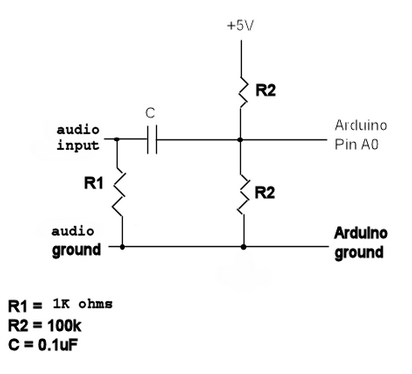

The Audacity website has a nice little Introduction to Digital Audio. You need to sample the analog at a known sample rate.
But before worrying about the sample rate, make sure you're getting "good data". You should be able to see the difference in silence (or "near silence) and louder sounds. Since the ADC can't read negative voltages the input should be biased and silence should read about half of the ADC range. You''ll need to subtract-out the silence for a WAV file, except 8-bit WAV files are biased and only hold positive sample values.
To "look at" the raw audio data you can run the Analog Read Serial Example (but take-out the delay).
When you look at the sample values they will "look random", even with a constant tone because you are sampling a wave.
I don't see why you need a temporary file. But if you have enough RAM (I don't know anything about that processor) you may want to make a buffer. The only thing special about a WAV file is the header.

Thanks a lot for the replies. This has been really helpful. I think I have a better understanding of what I need to do to get this thing working.
I understand why I'd bias the signal but how would I do that? would I be adding a 'DC' bias to the signal? if it is DC bias, would it need to be at 2.5 volts?

Yes, usually half of the analog reference voltage. Typical line audio input circuit for 5V Arduino, with AREF = 5V:
Capture
