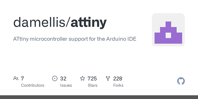

A good example of a platform like that is David Mellis's foundational "attiny" platform:
That platform leverages the resources of the "Arduino AVR Boards" platform using the referencing system.
