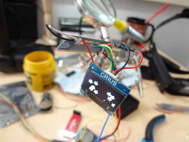

11-10-2013: Used it also with a Teensy++2.0 with the same code modification. It worked for some days and somedays not and tonight I got also snow!! I could only solve this by placing the 100 Ohm resistor in the Vcc line. I'm looking for a different combination of OLED and PCB (I don't have the eyes anymore for building one and/or soldering in this detail).

Thanks all of you for the helpful info. I want to say, the pcb of this diaplay is too bad, many bugs have to be fixed. As Peter said, two things I suggest the people with this display to do before using it:
first, reconnect the RESET pin, this must be done, otherwise the display may become crazy!
second, connect the pin19 and 20 together, this is easy, and your MCU can get correct ACK signal from the I2C bus.
After doing above two things, this display works well with my MCU(ATMEGA32).
Enjoy it,
-hy
Hi all.
Today i found some time to have another look at the display and was able to connect pins 19 and 20 from the glass.
Now the display also answers the Nick Gammon's I2C scanner with 0x3C.
I tried the sketch EVRE has attached, which shows the test texts.
It stops after i changed the address to 0x3D, so this is a difference between the other sketch i tried.
Still need the 100 Ohm resistor, or else there's only noise visible.
So now it's time to find out a way to use larger characters and be able to read the display from some distance.
I also tried to desolder the flatcable from the pcb, but wasn't able to do that.
How did you guys do that, what temperature did you set (if any) and did you put the iron at the pcb or direct to the plastic ?

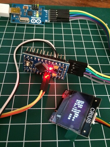

Hi for all,
This topics helped me a lot! I ordered a Crius V1.0 oled display from DX, but I got it working on my Arduino Duemilenueve and Mini Pro only after:
  • Insert an 100ohm resistor between 5v pin and Vcc
  • Soldering the 19-20 display pins together
  • Soldering and small cable on 14 display pin (reset)
