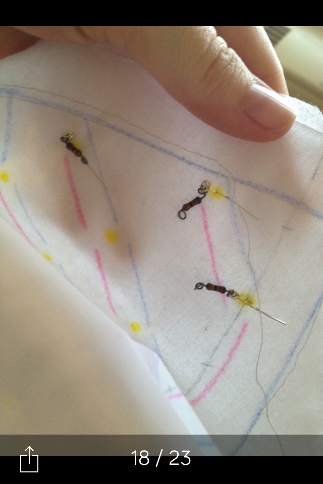

All the lights are wired in a parallel. Each light has its own resister. Warm white lights and red have 68ohm and bright white has 200ohm.

Each led is connected to each other. So there are wires connecting each resistor together and each opposite end of the resistor connects to led. I was careful too to face all the resistors the same direction even though I read that it doesn't matter. So very few wires connect to terminal.
