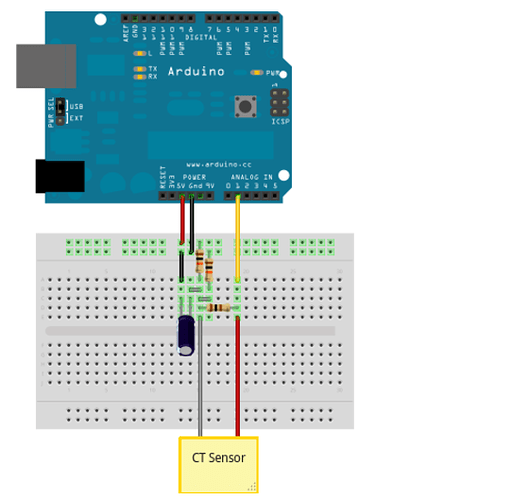

Please show us a schematic or at least a block diagram of how you have this whole thing set up and powered. How are you rectifying the AC from the current transformer so the Arduino can read the DC voltage?
Hi Paul,
I used this circuit for the sct013

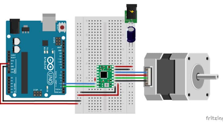

and this one for the a4988 and the stepper, I have an external power supply with 12v to power the a4988
Hope that helps.

See this example:

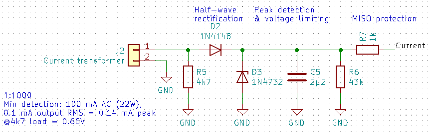

I miss a rectifier diode in that current detection circuit. Now you're still getting AC to the Arduino and the capacitor, neither of which are particularly happy with negative voltages. Also the moment you take the sample has a big impact on the reading as you're getting a waveform: the positive half of the sine complete, the negative half clipped at -0.5V by the protection diodes on the Arduino input.
This schematic I've used before and works fine.
Tune R5 for sensitivity, I had a 1:1000 CT.
C5/R6 is the peak detection. Tune to suit your needs.
D3 is for protection.

Depending on the current the OP wants to sense, R5 may be much too high. CTs can generate rather high voltages on their secondary without a proper "burden". What is the max current to be sensed?
