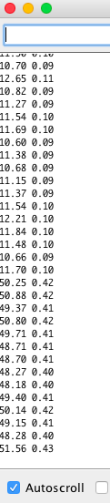

I did mod the code because we use 120V instead of 230V, and I wired up a lamp with one of those old energy saving phillips bulbs which is rated at 14W. When the lamp is toggled it goes from 11.09 apparent power (W) & 0.09 A, to 51.56 power & 0.43 Amps.
First off, my doubts about how it shows power flow when the lamp is off, so I wonder if there is a way (in code since the sensor doesnt seem to have a pot) to regulate it down to 0.
Second, 120V * 0.43A = 51.6 which is not Watts it should be pulling. Am I understanding apparent power incorrectly?

OK I took out a soldering iron, 40W. Again, I know, not much amperage, only 0.30A according to the kilawattmeter. This time I messed with the calibration factor in the code.
WITHOUT ANY CURRENT DRAWING
Its default to 111.1 so without anything in the sct, i took it down until it read near 0 (because if i plug in 0 then everything turns to 0). I left it at 0.1 for amps which gave about 0.01 for W.
WITH THE SOLDERING IRON RUNNING
But when I then connected the soldering iron (42W & 0.3A) the serial monitor read 20W or so power and 0 Amps.
So i took it back to 111.1 and this time with the soldering iron ON it read 60W and 0.4A, so I brought it down to 31 which is where it reads 42W and around 0.3A:
