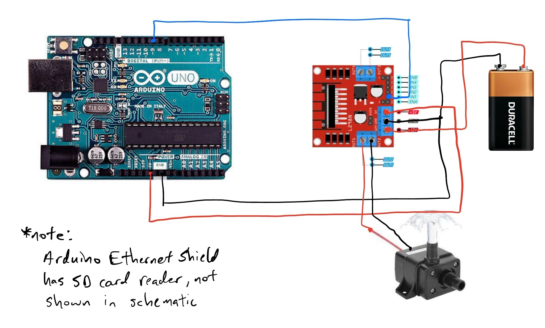

Here are the schematics with technology links, output values, input text file, and code (in order). The serial monitor outputs do not match that of our input from the SD card. We are trying to figure out how to fix this so that our L298N motor driver will run the water pump at variable speeds and that our output is more precise in reading decimals rather than rounding whole integers. Thank you for the tips and please let me know if I did anything else incorrectly!

Several things. The 9V battery will not cut it and the L298 driver will lose about 3 volts leaving 6 for the motor. Unless you are reversing the pump a simple N-Channel MOSFET would work fine and cut your energy loss to almost zero depending on how you drive it. Get one with a low Vgs (less the 3V) to run the pump.
What is this? I don't see a servo anywhere.
See this tutorial on how to use the L298 with an UNO
The link tells you this important facts: Voltage: DC12V/4.8W (AC is forbiden). If the voltage does not match, it will cause the pump to not work or burn out. Red is "+" and black is "-". Please wire it correctly.
