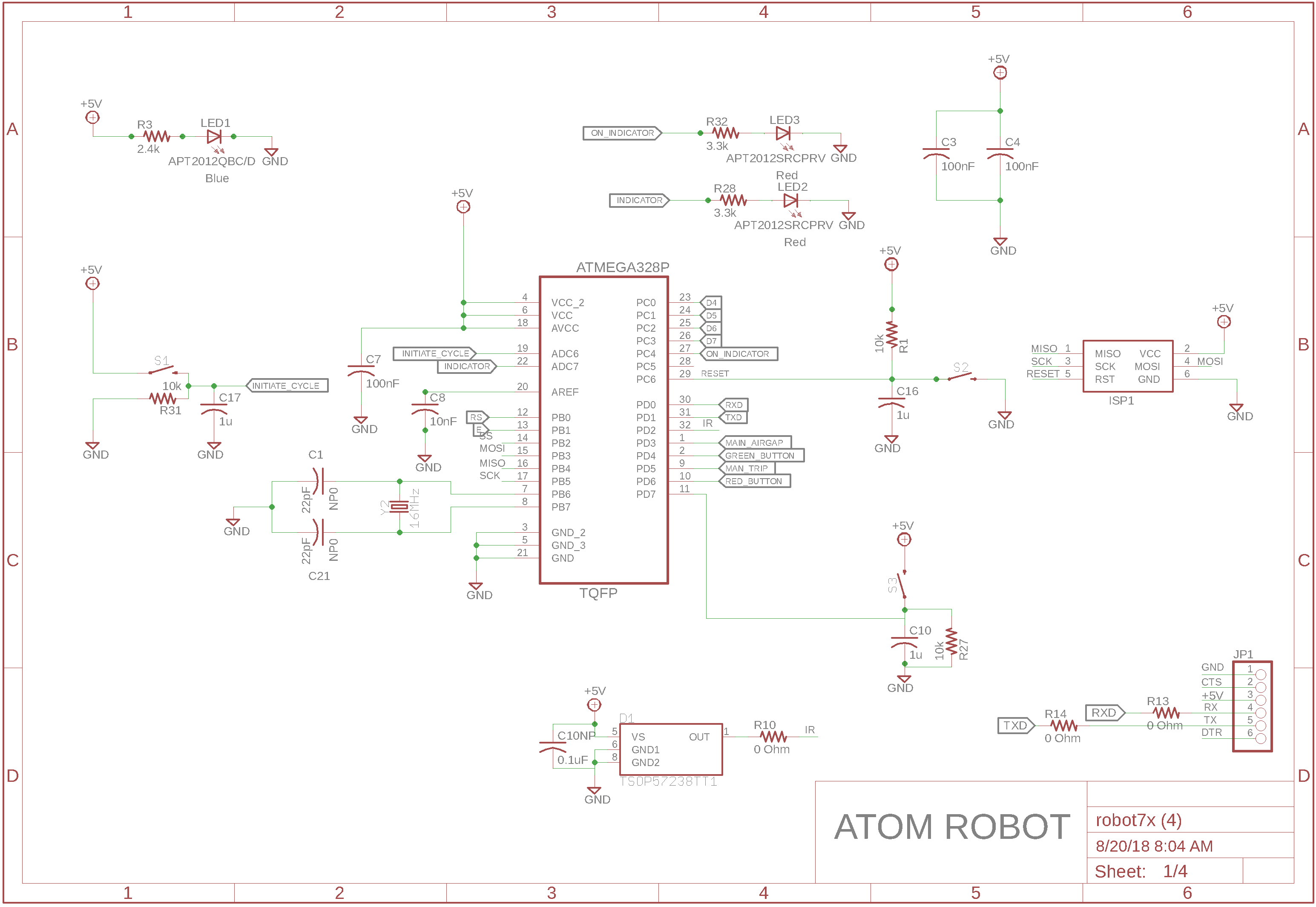

I am trying to program a new custom blank Atmega328p (TQFP 32 pin). I have a custom board spun with this chip. I have all the associated circuitry to get it working, including an external 16MHz crystal , ICSP , reset etc. ( I have attached a snapshot of the schematics below) .
The fundamental problem is that I am unable to flash the chip . The bootloader doesnt seem to flash at all and a regular blink program seems to flash but not work at all (without the bootloader).
I had three approaches after doing some deep research .
  1. I was able to read the fuses from the blank chip using avrdude and a usbtiny programmer. This was Lfuse : 0x62, Hfuse: 0xD9, Efuse: 0x07. I tried setting the fuses to match an arduino UNO that i have, which is Lfuse : 0xFF, Hfuse: 0xDE, Efuse: 0x05. As soon as i do this, I get a dreader error all the time after that , which is the following:
    "Initialization failed, rc=1"
  2. I tried to flash the bootloader directly using the arduino IDE, but the same error shows up. ( This is probably of the fuses set by the arduino UNO's bootloader which are the same as above.
  3. I tried flashing just a regular example blink led code. This seems to upload but doesnt run, as we dont see any pin toggle on the chip, using an oscilloscope.
I have already bricked 5 boards and i really need to get this up and running asap. Im trying to even figure out if its the fuses or any hardware issue. I checked all the individual pins of the chip and everything seems to be normal and compare with the arduino UNO's pins.
Please give your suggestions on what could be a solution and also how to recover the bricked boards!!

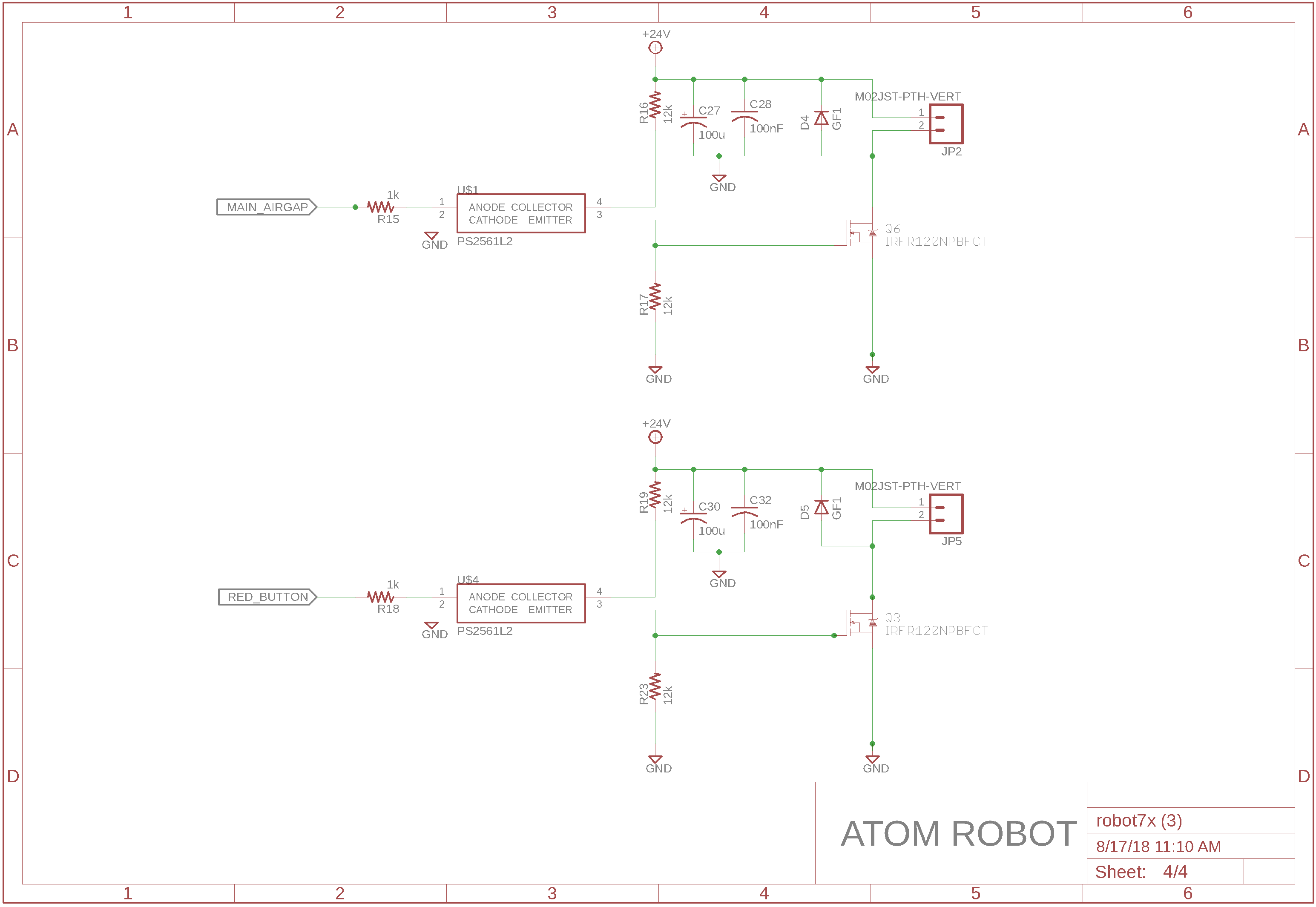

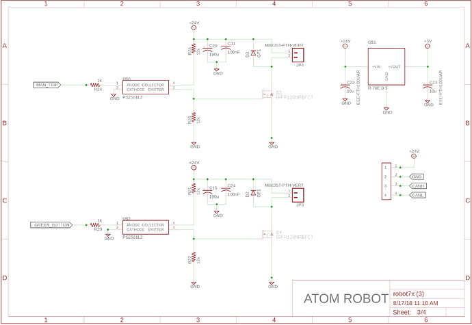

Thanks for the responses.
I have attached the entire schematic now.
Also, the circuit was tested with a 328p DIP package on a bread board assuming the SMD chip would work similarly.
And the above mentioned tutorial didn't work on the PCB board with the SMD 328p.
Tell me if this helps in figuring out anything.

You could not test the full circuit with a 328P DIP as that is missing ADC6 and ADC7 (A6 and A7) which are two analogue only pins on the SMD chip that you appear to be using as digital.
The serial program connection does not look right either, DTR does not appear connected, there is normally a capacitor between that and the processor RESET line.

Indeed ADC6 and ADC7 only go the ADC multiplexer, and are ADC inputs only, you can't power an LED from them.
Lose the capacitor on the reset pin, add a diode between it and DTR, cathode to DTR. Works for me, doesn't
cause damage to the reset pin's protection diode either.

While trying out various things since morning, I have come to a conclusion that it's because of the external oscillator. Tell me if this makes sense,
I tried flashing the bootloader with the boards.txt changed to the fuse values of the default chip (With the Internal Oscillator). And it worked!
I even uploaded code on the chip through the programmer and it worked as expected. (Toggled a few gpios)
All the 5 bricked boards had the fuses for the chip to work with the external oscillator. So I have come to a conclusion that this is a clock problem.
However, I can definitely see the 16MHz signal on the XTAL1 & XTAL2 pins (The fuses are set to Low power Crystal Oscillator mode with lfuse 0xFF matching the UNO). Any ideas now with this information?
I'm convinced it's not a software issue now as this works perfectly fine with the internal and also because I'm using the correct fuse values.
