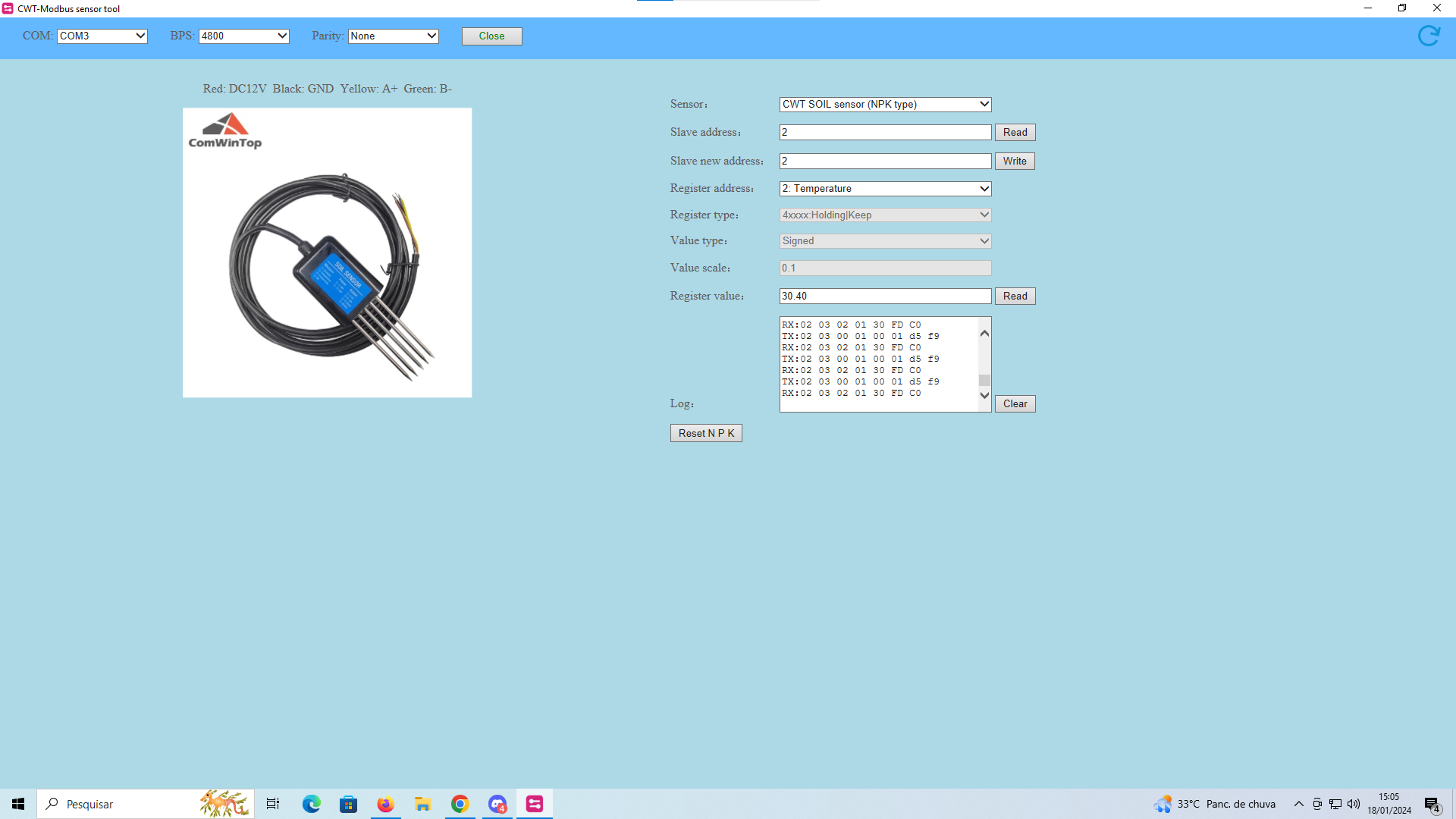

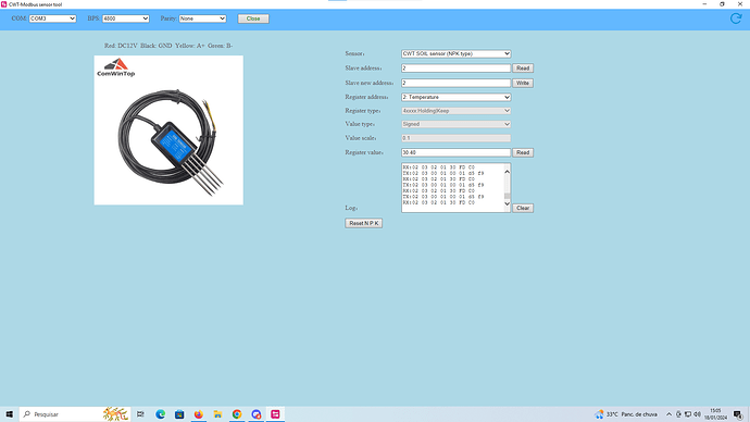

I bought and installed the usb adapter, could you help me?
Ok, so your sensor is responding to modbus requests.
The screenshot shows that your sensor address is 02. Does the PC software have the facility to change that address to 01?
If it doesn't, then you will need to recalculate the CRC16 checksums for the canned modbus messages.
You also need to change the baud rate of your modbus serial channel to 4800 baud.
When I try to change it to 01 it goes back to 02.
How do I recalculate?
