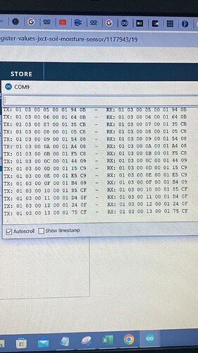

still I am getting the same result. I think there is fault in the registers which I am addressing
@markd833 seems to be onto something esp. if you used his code
Thankyou Markd833 for replying. So regarding the user manual. I just don't know what user manual is correct for this sensor, since my university bought it for my project. I tried contacting JHXCT for where I ordered the sensor. They said to me to contact the local buyer. I am attaching the box in which it came, incase other people can identify what is the correct manual for it. Currently I am using the manual which was released on 2020 and the register values are set according to it.

Now, here's another long shot. I've just pulled this bit of code together and done basic testing of it so don't expect too much!
The code sends out a canned Modbus query to device address 01 asking for the contents of register addresses 0x00 up to 0x2F (0 to 47) and then repeats.
I have a specific hardware setup so I use AltSoftSerial which must use pins 8 & 9 on the UNO.
Have a read of the code and get the CRC16 and AltSoftSerial libraries if you don't have them. Or you can stick with SoftwareSerial and change the code accordingly to match your setup.
Hopefully you will get a response from some registers. If you don't, then try changing the software serial port baud rate to 4800 baud and running the code again.

i did what you said.
Here is my circuit pic
and the result that I am getting is essentially the same there is no change in it
the code that i am using is

is there a problem with my RS485, I have two of them both are giving me the same result.
Ok, lets go right back to basics.
  1. Disconnect all the wires from your UNO board.
  2. Connect a single wire between pin 8 and pin 9 on your UNO.
  3. Run the Modbus scan code.
I've done this on an UNO I have here and here's what I get:
Modbus NPK register scanner.
TX: 01 03 00 00 00 01 84 0A   -   RX: 01 03 00 00 00 01 84 0A
TX: 01 03 00 01 00 01 D5 CA   -   RX: 01 03 00 01 00 01 D5 CA
TX: 01 03 00 02 00 01 25 CA   -   RX: 01 03 00 02 00 01 25 CA
TX: 01 03 00 03 00 01 74 0A   -   RX: 01 03 00 03 00 01 74 0A
TX: 01 03 00 04 00 01 C5 CB   -   RX: 01 03 00 04 00 01 C5 CB
TX: 01 03 00 05 00 01 94 0B   -   RX: 01 03 00 05 00 01 94 0B
TX: 01 03 00 06 00 01 64 0B   -   RX: 01 03 00 06 00 01 64 0B
TX: 01 03 00 07 00 01 35 CB   -   RX: 01 03 00 07 00 01 35 CB
TX: 01 03 00 08 00 01 05 C8   -   RX: 01 03 00 08 00 01 05 C8
Hopefully that works on your UNO too.
I did exactly what u said
  1. remove all the wires
  2. connect only a single wire between 8 and 9
This is my result same as yours
