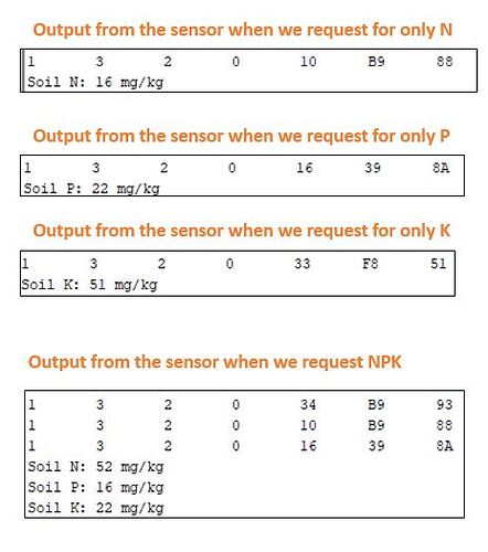

When I try to replicate the same using Arduino I am facing some issues. When I request for single sensor data the sensor is responding and I can read the sensor data.

It looks like your code should print out the actual bytes received from the sensor in hex. Can you provide a screenshot/screendump or cut & paste of the actual hex values you receive.
Hi Mark,
Following images shows the readings received when I request single sensor data and the values are within the acceptable range
When I request Ph and Moisture sensor data the out put is swapping
Ph_and_moisture
and when I request all seven sensor data than the order of output has changed
All_seven
In the above image the first value should represent for K but it is displaying as Ph

Following is one more example of change in output
The N value is getting associated with P
The P value is getting associated with K and
The K value is getting associated with N
If I request for single vale then it is working fine
Can you show the actual commands you send to the device and the associated responses. I couldn't find a manual for the sensor that clearly detailed the messages - specifically which addresses to use for which type of reading.
Or better still, post your current code.
Hi Mark,
I am using following commands to request sensor data
nitro[] = {0x01,0x03, 0x00, 0x1E, 0x00, 0x01, 0xE4, 0x0C};
phosp[] = {0x01,0x03, 0x00, 0x1F, 0x00, 0x01, 0xB5, 0xCC};
potas[] = {0x01,0x03, 0x00, 0x20, 0x00, 0x01, 0x85, 0xC0};
Following is the code
NPK.ino (2.2 KB)
The checksums all look correct for Modbus.
I'm not sure that checking if 8 bytes have been written to the software serial port adds any value in this case. But I do wonder if you should check that a byte has been received by the software serial port before doing a read().
My only other suggestion at the moment is if you have a way of listening to the RS485 comms independently to see if this is a sensor issue or a software issue.
