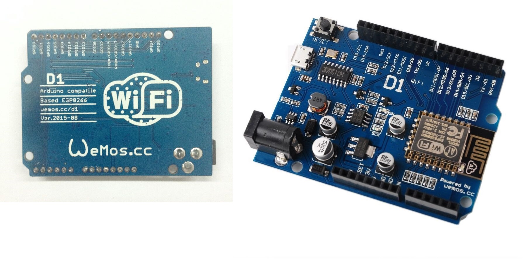

Hi All,
I just got the Arduino Compatible Based ESP8266 Wifi Board, which is D1 Wifi. Finally I was able to making the board detected in Windows 8.1. The blue color ON and SCK LEDs were light up and still all the time after the board connected and the Wifi module will blinks once when the rest switch was pressed.
When I was trying to compile and upload sample code to the board, I got these errors... :sob:

Hi pert,
Thanks for the guidance. This problem solved by changing the board from Generic ESP8266 Module to WeMos D1 (Retired) the sample able to upload to the board and I saw the ESP8266 blue blinking during uploading process. Using Serial Monitor, I saw the returned message from the board.

waheedrafiq reported this topic to the moderators as follows
Hi moderators ; I have found fix for this error it happens to be the pin 0 and pin 2 on the digital side can't be used with WeMos D1 board , I think its due to the TX /RX
