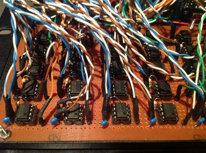

The current failing system is using a IOWarrior56 which is connected to a Ethernet Rack panel, which via USB reads the inputs of the treadmills via a small timing device similar (attached in image) that are connected to the treadmills and then wired into the Ethernet Rack. I believe there is a RS485 chip in the same module as the IOWarrior and the timing devices also have one as well. guessing the communication is then done by serial.

Unless you put a Arduino + Ethernet shield in each treadmill, you are going to need some sort of sensor mechanism in each one. I would use an oscilloscope to check whether the devices shown in your board are generating good timing signals, to see whether you can still use them and just replace the IOWarrior with an Arduino + Ethernet shield. Also find a schematic or trace the wiring of those boards.

You will need some sort of transmission mechanism between the treadmills and the Arduino. The board in your photo uses an opto-isolator, so if it really is RS232 then it must either be using the old current loop interface or some nonstandard interface. However, there is no way you will be able to receive 55 simultaneous RS232 signals on an Arduino.

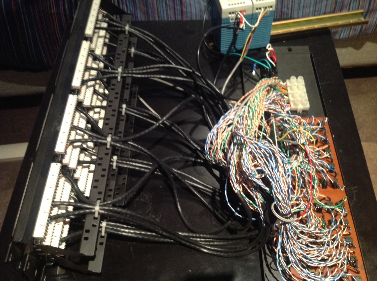

So there is a 12V power supply that sits in the box with the IOwarrior currently that transmits power down 55 ethernet cables via a CAT5e connectors on each site, one for the smaller device shown earlier, and the other end if the reciever device which is currently the holding place of the IOWarrior.
either side has a RS232 chip for communication, and then the response from the RS232 chip is then passed directly into a single Input Pin on the IO Warrior. i presume i can do the exact same thing, but just replace the IOwarrior with the Anduino… or am i totally wrong about that :stuck_out_tongue:
Im just making sure i guess that the current solution is not over engineered, to the point where it is not functioning as well as it could be.

Attached photos of the internals of the current master device.
As I said before, an Arduino is the wrong device to receive 55 x RS232 channels concurrently. It might just be possible if the baud rate is very low, but the software would be complex. However, if the boards are silent most of the time and then send a single character over the RS232 when one motor rev occurs, then you only need detect the start of the character, and it becomes much easier.
