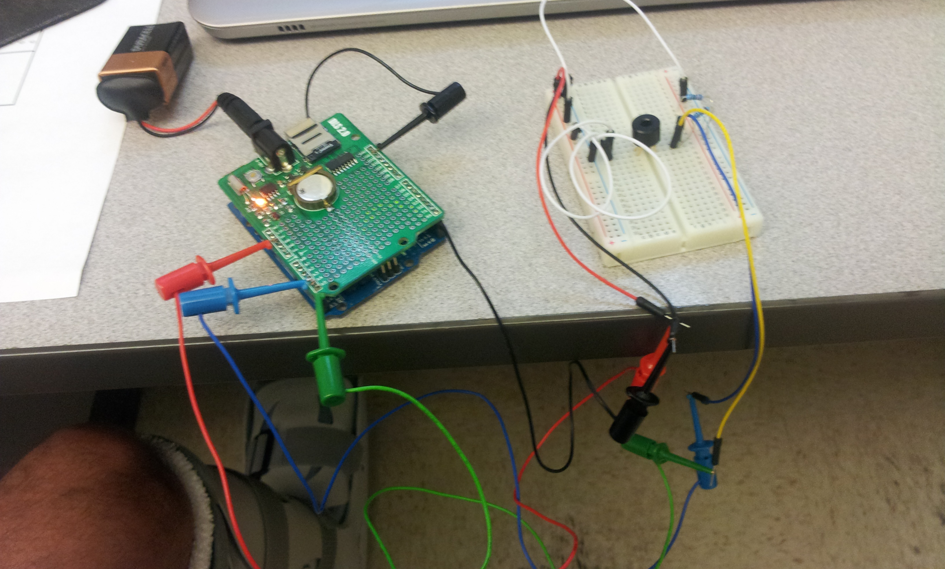

My project:

Hi everyone, I made it work!
The main problem was that I was not putting the libraries in the same folder of the .INO
I thought I just had to put it in arduino/libraries.
Right now the only problem I have is that the Arduino is turning off when it has to change the HOUR. Strange problem, but still..
What is the code right now? Because that is a bug that is hidden somewhere.
This is the code:
#include <SD.h>
#include <OneWire.h>
#define DS1337_ADDRESS      0x68
#define ONE_WIRE_BUS        10
#define SD_CHIPSELECT       8
String strLogline = "";
	GetDate();
	WriteSD();
void SetAlarmMin(uint8_t AntallMin)
Wire.begin(DS1337_ADDRESS);
Wire.beginTransmission(DS1337_ADDRESS);
Wire.write((byte) 0);
Wire.endTransmission();
Wire.requestFrom(DS1337_ADDRESS, 2);
Wire.read(); // hopper over sekunder
uint8_t mm = bcd2bin(Wire.read());
mm = mm + AntallMin;
Wire.write((byte) 7);
Wire.write(0b00000000); // Alarm 1 sekunder
Wire.write(bin2bcd(mm)); // Alarm 1 minutter
Wire.write(0b10000000); // Alarm 1 timer (flagg satt)
Wire.write(0b10000000); // Alarm 1 dato (flagg satt)
Wire.write(0b00000000); // Alarm 2 minutter
Wire.write(0b00000000); // Alarm 2 timer (flagg satt)
Wire.write(0b00000000); // Alarm 2 dato (flagg satt)
Wire.write(0b00011101); // skru av ocillator og enable alarm 1
Wire.write((byte) 0); // Nullstill alt
	SetAlarmMin(10); // Sets the alarm 10 minutes for now
So the next line I think is going to solve the problem:
if (mm > 59) mm = mm - 60;
But I'm testing it right now,, I let you know how it goes!
