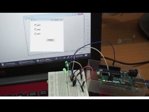

This is a project created to make LEDs light up on command by making VisualfoxPro and Arduino communicate.
my goal is a little different.
I should be able to transfer data from Arduino to Foxpro from a sensor. a data stream.
I also leave a blog guide that explains how to connect Arduino and Visual Foxpro.
the problem is that I can't understand how to transfer the Arduino sketch to Visualfox pro.

That's not how it works. Each side runs its own code, entirely unaware of what is on the other side (other than something is supposed to be there). They communicate solely through serial-over-USB.
  • sketch on Arduino
    • built-in serial with Serial
  • form on VFP (the sample code below from that thread you linked)
    • a form component that wraps an object that can send information to the serial port
      PUBLIC oForm
      oForm = CREATEOBJECT("Form")
      oForm.ADDOBJECT("comm", "olecontrol", "MSCommLib.MSComm")
      WITH oForm.comm
      .CommPort = 1 && Set to your COM port number
      .Settings = "9600,N,8,1" && Match baud rate and settings
      .PortOpen = .T. && Open the port
      ENDWITH
      * Send "Hello World" to Arduino
      oForm.comm.Output = "Hello World" + CHR(13) + CHR(10)
      After assigning a few settings properties, data is sent by assigning to the Output property.
In that case, the bits flow in the other direction. On the Arduino, you'd use Serial.print. In VFP, you apparently read the Input property, either by
