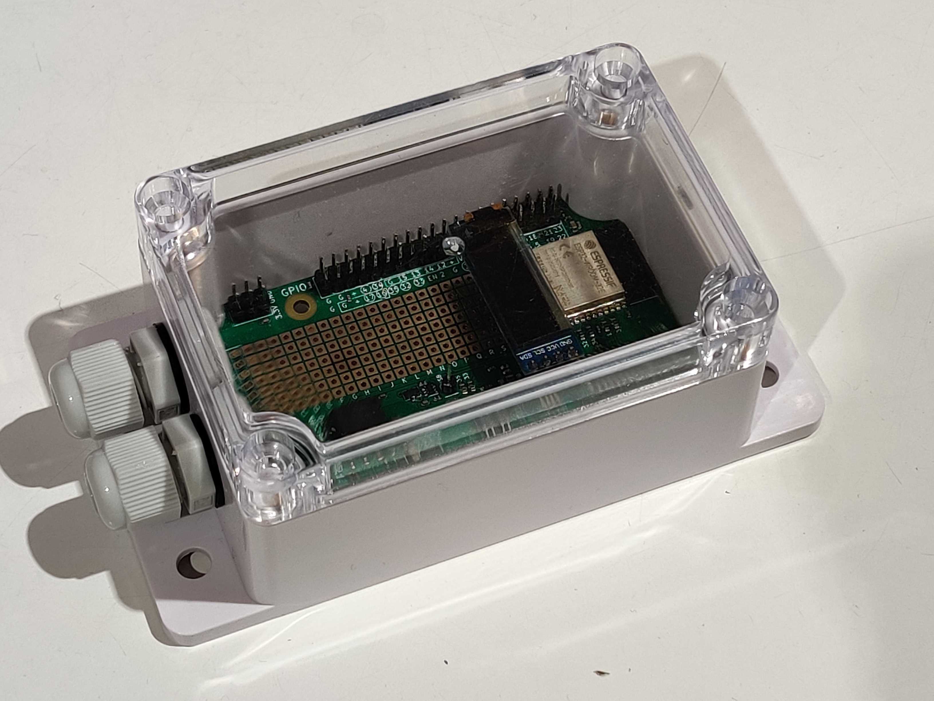

Something like this could be reliable enough.
An ESP could be the best choice since you can use the sleep mode.
About battery, there's many examples of solar and battery powered projects over the internet.
Hi
That looks great! Do you know where i could find this?
That looks perfect.
@FernandoGarcia
Google is your friend.

The arduino will be fine if properly protected. That enclosure looks like something that you can find at Polycase.
I'd be more concerned about the LVDT. They're not exactly power-sipping unless you can control the excitation and only turn it on periodically. What are you using to interface arduino to an LVDT?
Ok thank you. That looks like a great site aswell.
