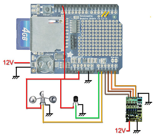

The Arduino is a standard Uno V3
Uno
Upon it is mounted an Adafruit data-logger
Adafruit Datalogger
This will use only the 6 analogue pins to make "relative" measurements.
These 6 pin are distributed as such:
1 for the temperature sensor, TMP 36 with the on board 5V.
TMP 36
1 For the wind speed sensor; a DIY anemometer that registers 0 to 3.3V.
Anenometer log
4 that are connector to 4 load cells, with a DIY analogue amplifier.
The signal with no force is 1.5V, the max is 3V, the min is 0V.
Analogue Amplifier
This has been converted into a PCB and bodged to spec.
Finalising PCB
All is supplied with a single 12V/0.9A powers supply.
The ground is common amongst all the parts.

Sequence that I'm trying to code:
Read clock, save result as RTC
Read pin 0 1times over 1mS, save results as TMP.
Delay 4mS
Read pin 1 10times over 10mS, save results as WDS.
Delay 5mS
Read pin 2 5times over 5mS, save results as LC1.
Delay 5mS
Read pin 3 5times over 5mS, save results as LC2.
Delay 5mS
Read pin 4 5times over 5mS, save results as LC3.
Delay 5mS
Read pin 5 5times over 5mS, save results as LC4.
Delay 4930ms
Start loop again

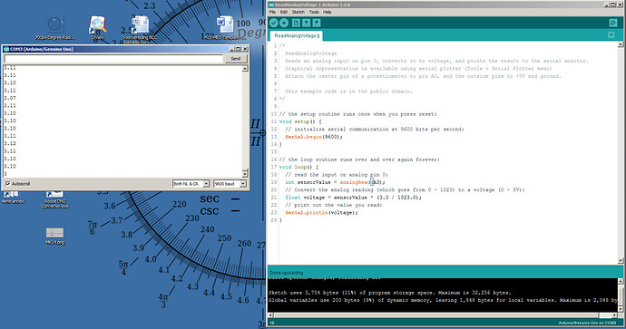

But right now, I'm back to square one...
I'm probably missing something basic/silly.
I am using 2 Adafruit datalogging shields to log 2 sets of 4 independent load cells and I'm stumbling at the last hurdle...
The Aduinos Uno are stock, no jumpers.
When all the cells are plugged in, the shields lock up when the green LED is lit (that's during the write stage of the loop).
The load cell circuit emits 1.5V with no load. A positive load makes them go towards 0, negative load makes them go toward 3.3V.
The code I am using is based on the one provided by Adafruit, simply modded for the 6 analogue signals:
