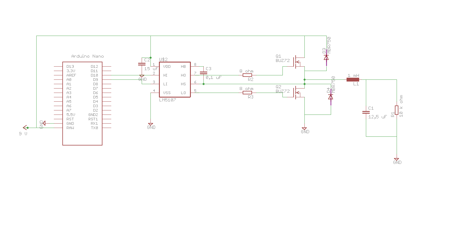

Circuit:
My circuit wiring is attached to the post.
I had to change the mosfet driver in favor of an easier one to solder (LM5107 of Texas), but the working principle is the same. The only difference is that the bootstrap diode D1 is integrated in the driver, so I removed it from my circuit.

OPs original circuit.
I think you will find D1 needs to be a Schottky Doide, not 1N4004.
Tom... :slight_smile:
Well you had better post that circuit, cos the one you posted is not relevant.
Tom.. >:( >:( >:(
Right, I corrected the diagram, here is the up-to-date version.

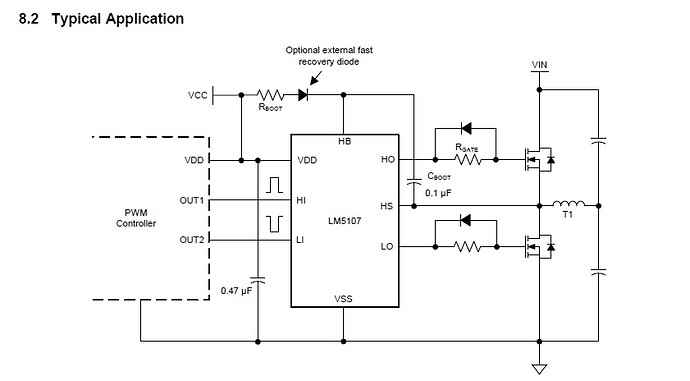

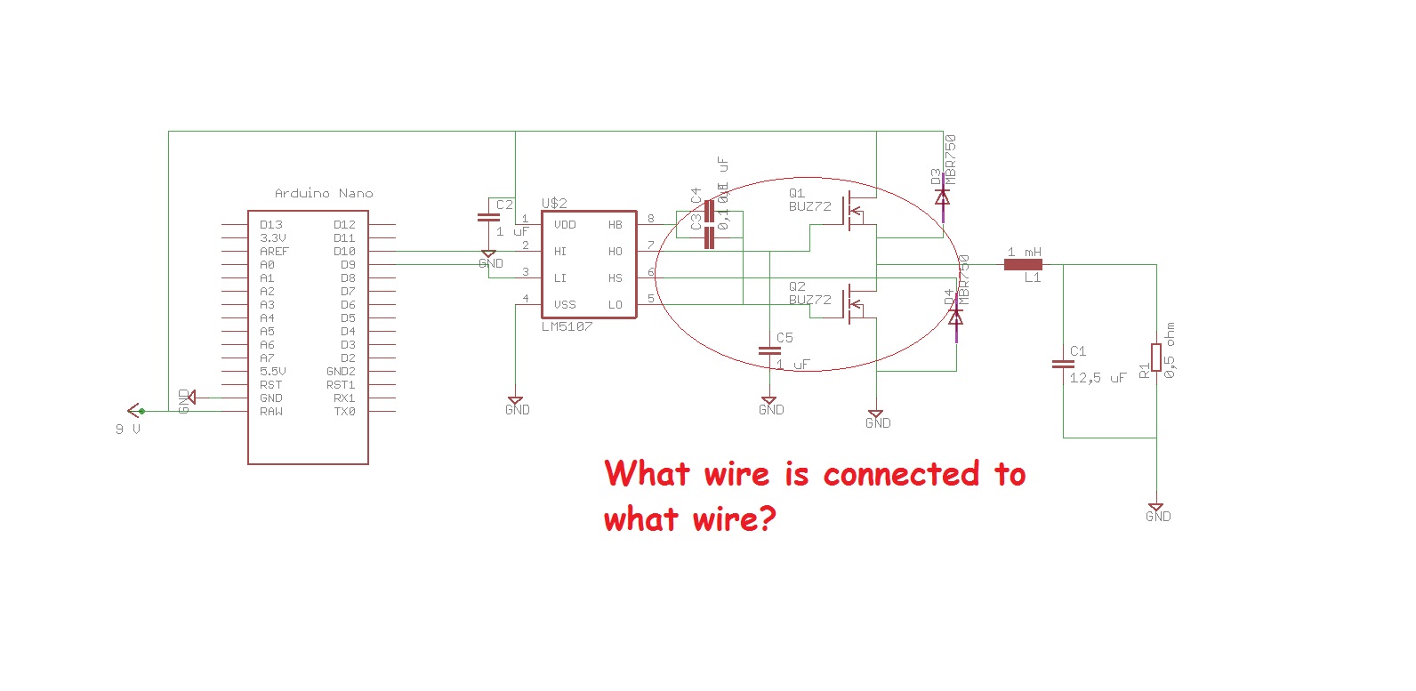

I hope you haven't got your circuit connected as in your diagram?
It should resemble this.
Tom.. :slight_smile:
Where did you find this diagram ? I couldn't find it or anything alike in the datasheet. I helped myself with the pin indications of the datasheet.
I don't have the capacitor between the high mosfet drain and source. what is it for and how big should it be (or how do I calculate its value)?
I also don't have the gate resistor, because I calculated with the method I found here that the internal gate resistor of the mosfets were enough.
But I just noticed a stupid mistake I made using the method, so it's just wrong. I definitely need those resistors
I don't have the antiparallel diodes to the gate resistors either, what are they for?
I'm going to fix my circuit and test it right away.
Murmeltier:
I googled LM5107 data
Can't attach it too big.
Murmeltier:
Ignore that, its just the class-D output load which isn't relevant.
No, you don't need resistors, the output impedance of the driver will do the job for you. The diodes are a way
of having fast switch-off and slow switch-on, assuming you wanted slow switch on in the first place
(I've never needed that!)
Its OK to just drive the gates directly from the chip, that gives the best switching efficiency (although can
produce more EMI/noise). Fewer parts simplifies things. The driver chip must have good decoupling though,
10uF ceramic or so directly across its supply is probably going to work nicely.
This driver chip has no protection against shoot-through, note, so its up to you to ensure you allow
enough dead-time.
And the bootstapping method means the hi input must be parked low, never parked high (which for PWM
means never going above about 95% duty cycle).
Well, I didn't have a 10uF ceramic so I put a 15uF Elko instead.
I also added 8 Ohm each gate, basing on the mosfet driver datasheet.
Still not working.
If the PWM goes in the Low Input of the driver, it's working alright, although not as cleanly as before.
But if the PWM output and the High Input of the driver are linked, still nothing beside the occasional quick signal distortion after a few seconds

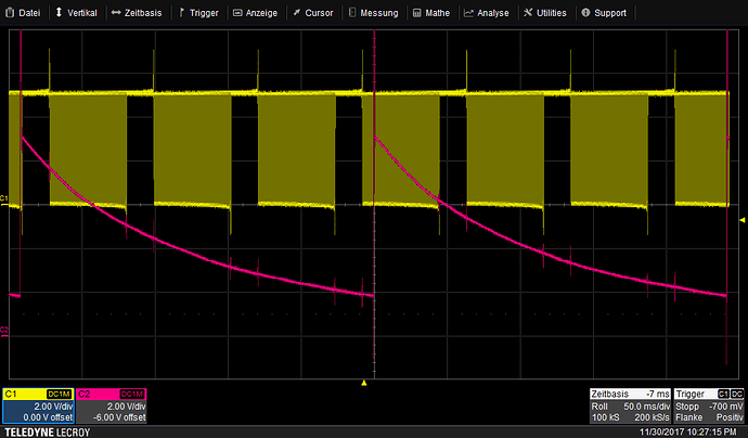

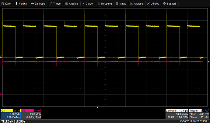

Do you have an oscilloscope?
Do you have a DMM?

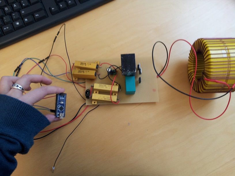

Can you post an up to date circuit diagram please, and a picture of your project?
Thanks.. Tom.. :slight_smile:
I have both an Oscilloscope and a DMM.

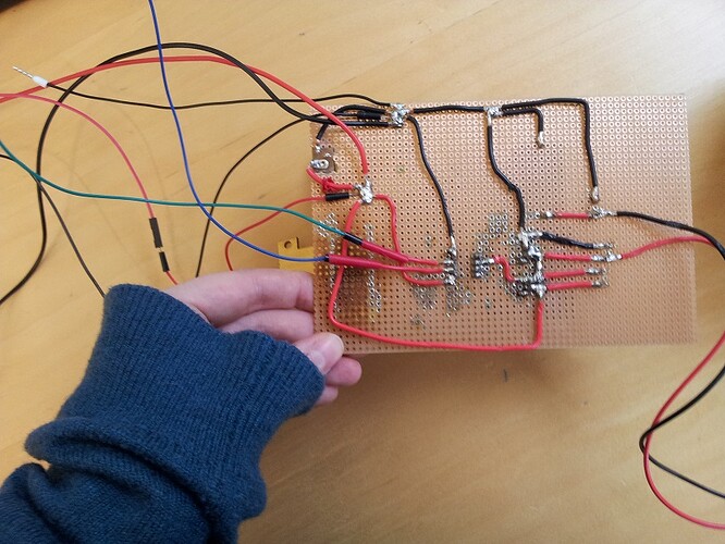

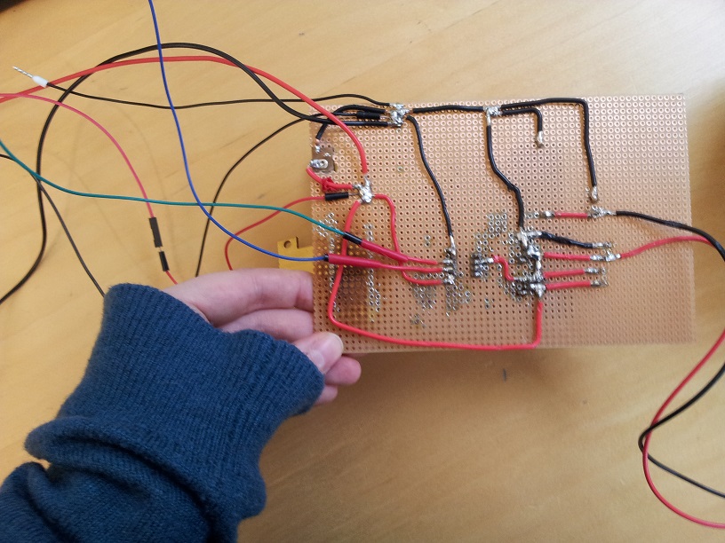

Here are a the updated circuit as well as pictures of it.
The two mosfets are hidden by the cooling element.
I also tried the whole thing with the anti parallel diode to the gate resistors, and the capacitor between the drain of the High Side mosfet and the inductor just to be sure, but I didn't get any different result.

I replace the output resistor by a 10k Ohm one, and was finally able to get a signal in and out the mosfet driver (high side). Here it is:
https://img15.hostingpics.net/pics/436000ens10hz108.png
https://img15.hostingpics.net/pics/527270ens10hz109.png
In both pictures, the yellow signal (ch 1) is the output PWM of the mosfet.
The pink signal (ch 2) is the high output of the mosfet driver.
The only difference between the pictures is the time resolution (bottom right corner of each pictures). The output of the circuit, at the 10k resistor, looks exactly like the output of the mosfet dirver (pink line)
So my three questions now are:
  • Why isn't the output of the mosfet a PWM to drive the mosfet?
-Why isn't the output of the circuit a continuous voltage? (because of the weird driving maybe? Or is it a capacitor problem? )
My aim is to load a battery with this circuit, with current up to 10 A. The internal resistance of a battery is about 0,5 Ohm, maybe 1 Ohm. I cannot keep the 10k Ohm resistor.
So:
-why isn't the mosfet driver working with such a small load? (or how do I make it work)
Here is the circuit once more. Only changed thing is the resistor value on the right.
