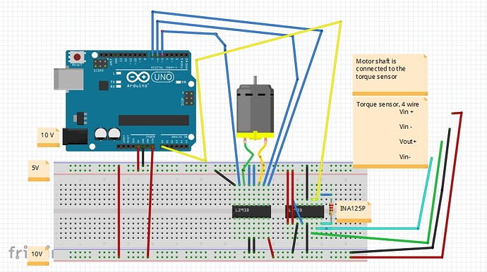

Hi guys
Thanks alot for your replies. Will you comment on, if this will work: (See attached diagram)
I have a 12 V dc motor (running at 1 RPM) and a torque sensor. I would like to be able to drive the motor in both directions and continiously read the motors torque with the sensor. The torque sensor is attacted to the motor shaft, and an an elastic band is also attached which will resist more and more, the further the motor is running. I will use an INA125P IC to boost the torque sensors signal and let the Arduino plot the readings in the serial.
Then I will use a H-bridge (L293D) to control the motor and stop it, when a specific value from the torque sensor is reached in the serial.
I would like the motor to run clockwise until e.g. a voltage of 2.0 is read in the serial, then the motor should stop a few seconds, before running back to the starting position.
The motor should then drive counterclockwise to -2.0 and stop, and drive back to the starting position.
Would you be able to program something like that in Arduino, and am I missing some components?
