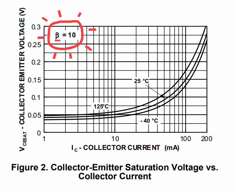

ReverseEMF:
Notice how, in that VCE(sat) entry, along with an IC stipulation, there is also an IB indicated? That's because, to turn a transistor on "hard" for switching purposes -- I.e. put it into saturation -- the Beta needs to be 10.
The Beta needs to be 10? Does that mean I should get transistors with a beta of 10 for switching applications? The beta is listed on the device datasheet, right?

ReverseEMF:
For a switch, the beta is in the lower ranges -- typically 10. For, applications in the active range, the beta is higher. It's like an Op-Amp. The beta rating of a transistor is like the open-loop gain of an op-amp. And the functional beta of a transistor circuit is is like the gain in an op-amp circuit, programmed by the resistor network.
I repeat, beta is the small signal current gain, its nothing to do with operating a transistor at saturation, and
its measured in the standard forward region of operation.
At saturation the base collector junction is forward biased, there is no transistor action in the standard sense
as the collector repels charge carriers from the base rather than attracting them. The current flows because
the density gradient of charge carriers is extreme(*), and carriers from the emitter have a better than evens
chance of diffusing to the collector before interacting with the base electrode. In fact usually 90% chance or

MarkT:
OK, maybe I'm using the term incorrectly. I learned that Beta is the ratio of lC to IB. Typically, when the VCE(sat) is specified in a datasheet, it includes the IC and IB where this saturation voltage is expected, and is usually a ratio of 10 to 20. So, this is not Beta? I understand that there is a beta [typically referred to as "hFE"] for the active region of the transistor [the maximum Beta?]. But, it's my understanding that there is also a "forced Beta" for driving the transistor into saturation, or near saturation.
I mean, the lC to IB ratio varies for different operating points, even in the active region. Transistor datasheets often specify more than one hFE, for various Collector currents.
In the regions, near saturation, the ratio can be quite a bit less. In fact, this ratio doesn't just, suddenly change from the datasheet hFE, to the 10 or 20 ratio that occurs when the transistor is "turned on". It's a smooth transition [not linear, but also, not sudden]. So, at what point does it stop being the Beta, and exists, merely, as a current ratio?

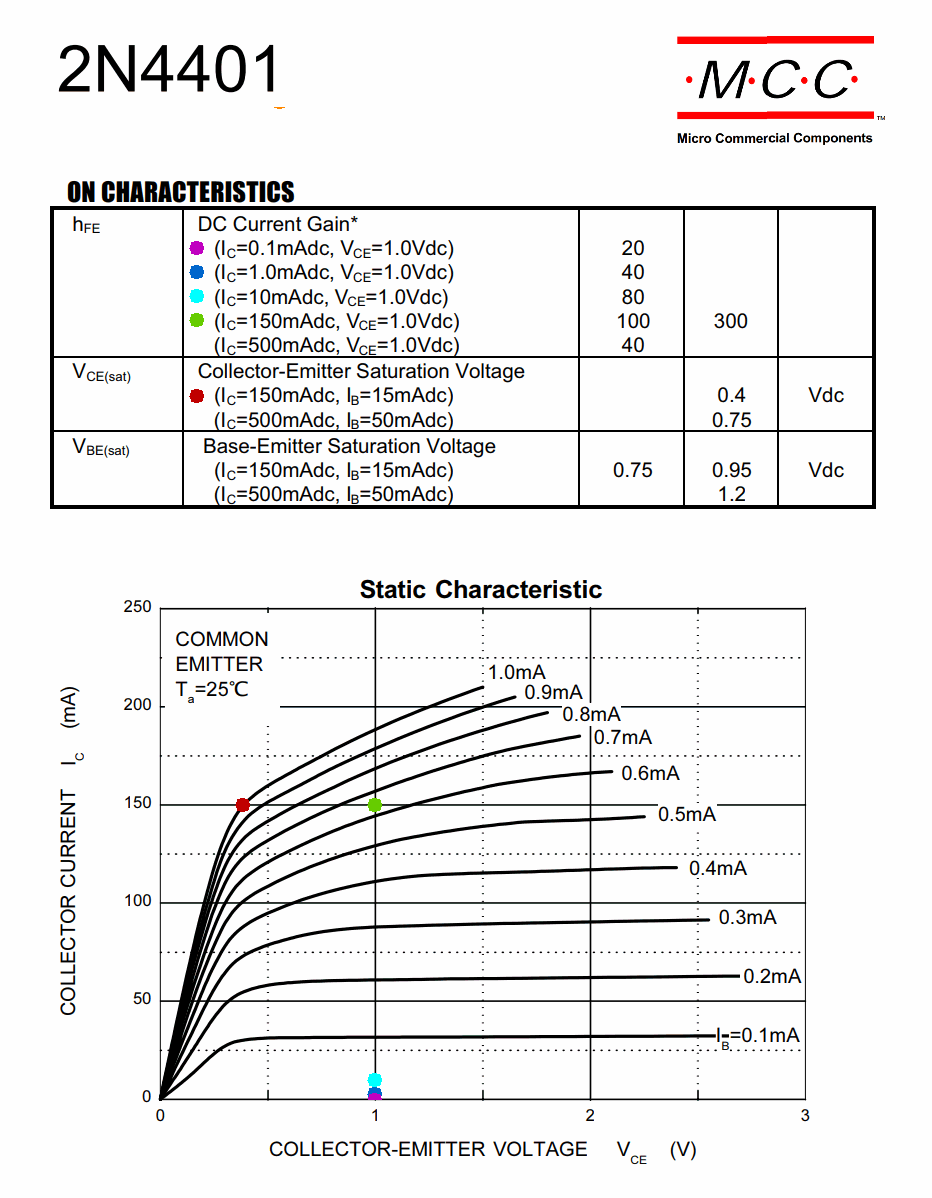

ON Semiconductor/Fairchild appears to disagree (unless the Greek letter β doesn't refer to Beta):
This is from the ON Semi 2N3906 datasheet.
And, here's a diagram showing that hFE is not just one value, but can be vastly different depending on operating point.
I suppose you can argue that the VCE(sat) point (red dot), is not a Beta value, because the transistor is in Saturation, but, it's still the ratio of IC to IB, which, as I understood, is the definition of Beta. So, maybe the point of contention is type of Beta. Perhaps the distinction is Active Region Beta, vs.Saturation Beta. OR, Maximum Possible Beta [those hFE specifications on the datasheet] and Forced Beta [i.e. using Beta to position the operating point on the Characteristic curve]. For switching, the goal is to get as close to the ideal switch model in a tradeoff between practicable and practical. This usually means a Beta of 10 to 20. For a, for instance, Class A amplifier, the beta will, typically be set to a higher point. But, rarely will the transistor operate at its maximum possible beta. Usually a linear amplifier design goal is to swamp out variations in beta [due to temperature changes, changes in collector current, and production variances].
