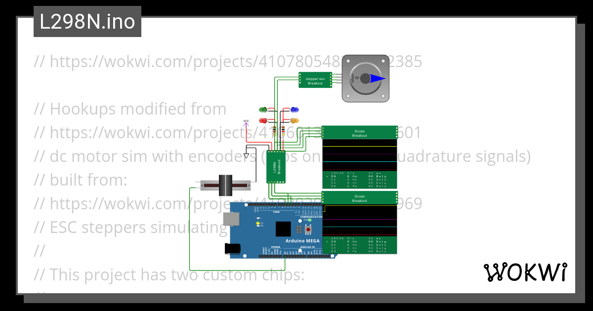

The code as-is works for me in simulation:
If your joystick is limited to the 370-770 range, you might want to look at this line in your code:
and consider what map does:
If 770 is your top value, try replacing the 1023 with it so when you get to 770 on the joystick, it is putting full power (analogWrite(speedP, 255);) to the motor instead of half with analogWrite(speedP, 128);
