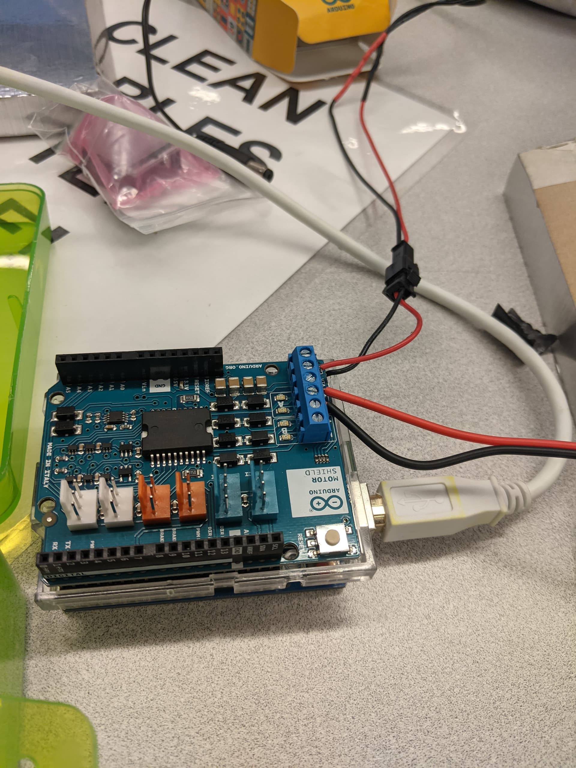

DC motor not spinning when powered by 12V supply - Arduino Uno with Motor Shield REV3
Code:
int directionPin = 12;
int pwmPin = 3;
int brakePin = 9;
//uncomment if using channel B, and remove above definitions
//int directionPin = 13;
//int pwmPin = 11;
//int brakePin = 8;
Serial.println("setup");
//define pins
pinMode(directionPin, OUTPUT);
pinMode(pwmPin, OUTPUT);
pinMode(brakePin, OUTPUT);
Serial.println("program start");
digitalWrite(directionPin, HIGH);
Serial.println("reached forward direction");
//release breaks
digitalWrite(brakePin, LOW);
Serial.println("disengage brake");
//set work duty for the motor
analogWrite(pwmPin, 5);
Serial.println("spin motor");
delay(10000);
All the serial println commands are going through but the motor seems to not be rotating. It somehow worked the first ever time I ran the program but it hasn't ever since.
Using this setup:
Where is the UNO? Show the lot.
works after trying
analogWrite(pwmPin, 254);
