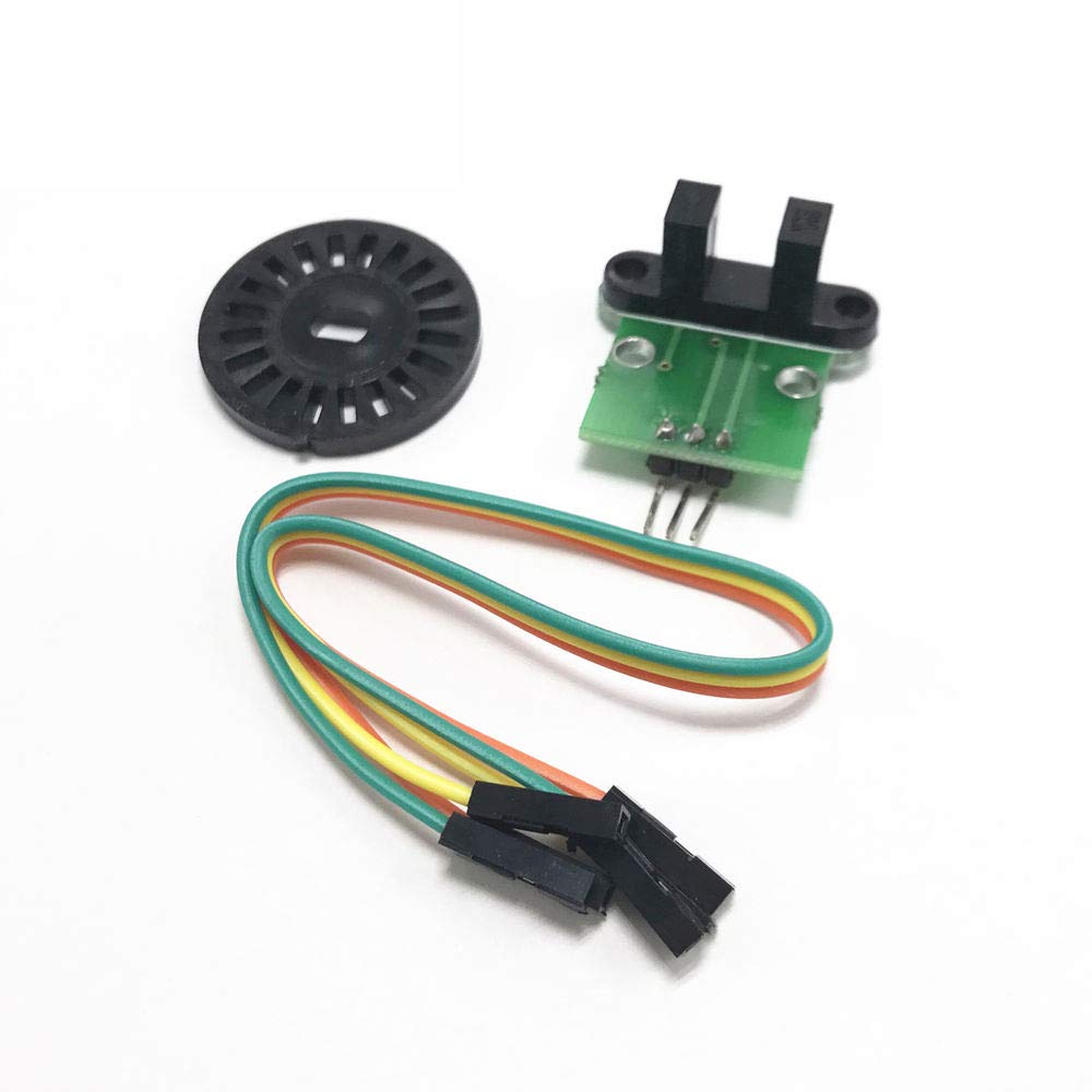

I am trying to build a 4 wheel mobile robot. Right now, I am trying to set up the DC Motors with my encoders. Cheap ones but it should produce some metrics white spinning. I am having some issues with the language or the hardware I have placed. I dont know.
My issue is while reading the values from the encoders. Please find attached a youtube video and the code running.
What' s expected
I am expecting to have a LED turn on/off as the Encoder LED turn on/off. It seems that the onboard ARduino LED is not allied with the motor encoder LED. It feels like there is a delay here? Am I missing something? I have also used RISING & CHANGE.

Please post a link to the encoder.

https://www.amazon.com/HC-020K-Double-Measuring-Photoelectric-Encoders/dp/B07VJJT1C9
Description: HC-020K speed measuring sensor is a wide voltage, high resolution, short response time, and the switch output speed measurement module. It can test motor's rotational speed with black encoder (measured spec. is related to the encoder, the inner diameter of D type encoder that provided is 4mm, can be used for motor output shaft w/ 4mm diameter, which is TT motor we matched, yellow shell and white axis).
Features:
Module Working Voltage: 4.5-5.5V
Launch Tube Pressure Drop: Vf=1.6V
Launch Tube Current: If<20mA
Signal output: A, B two lines; TT power level;
Resolution: 0.01mm
Measurement frequency: 100KHz
Disc diameter: 24mm
Inner Disc Diameter: 4mm
Encoder resolution: 20 lines
Speed measuring sensor configuration: measure line 1 motor speed
Application: For experiment
That circuit is a "Schmidt trigger" which has hysteresis, so it should not give multiple transitions.
But you can check for that by slowly rotating the wheel past one slot in the encoder disk, and see if you get multiple counts.
